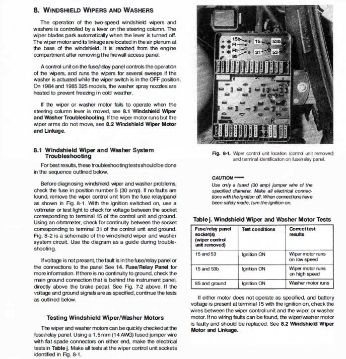

                  Right you were sir. I just trouble shot the relay per the TS handbook procedures (dang that sounded slick) and found out some interesting things. First off there IS a constant hot there in the box itself, idk why but there is. It seems the wiper switch inside the car is just a "sending" unit and the motor gets it's main power from the relay via the battery direct (smart no burnt circuits in the steering wheel column). I then went ahead with the TS procedure and everything checked out so my relay is bad. I think some nimrod may have disconnected the wiper motor arm. Now it looks like to me to get into the firewall I have to take a plethora of stuff lose, I would prefer not to do that. Can I access it through the black vent above it? I eagerly await your tutelage.
