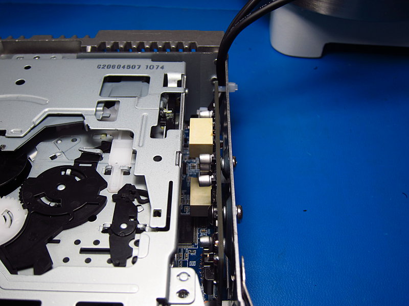

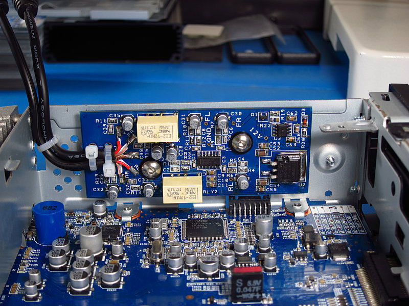

            Ho ho ho...Not exactly sugarplums danging around, but these will definitely be more fun to stick in a car. I have all the components needed to make 10 of these, so I will be building the first one over the next week or so and giving it a test to make sure that things work properly. From there, we'll see!
            Here's where it mounts in the RMT200.

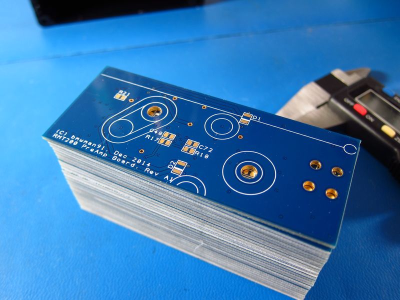

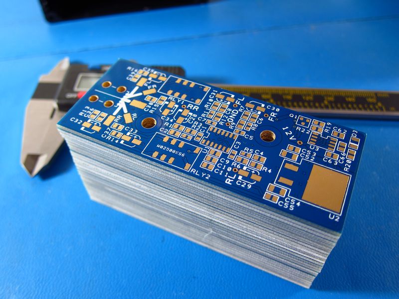

                    Where do you get your boards made?
                    • bmwman91
                      • Oct 2004
                      • 3128
                      #55
                      This was my first experience with them, and I was hesitant at first because they were quoting me at like 50% less than the place I was using. Some guys on the diyaudio forums had tried 3pcb and got good results, so I have it a shot and so far things look good!
                      I do my schematics and layout in DesignSpark PCB. It's free for commercial and non-commercial use. You sort of need to make your own symbol and footprint libraries, but for a free program it is super good.

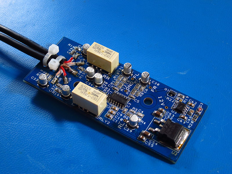

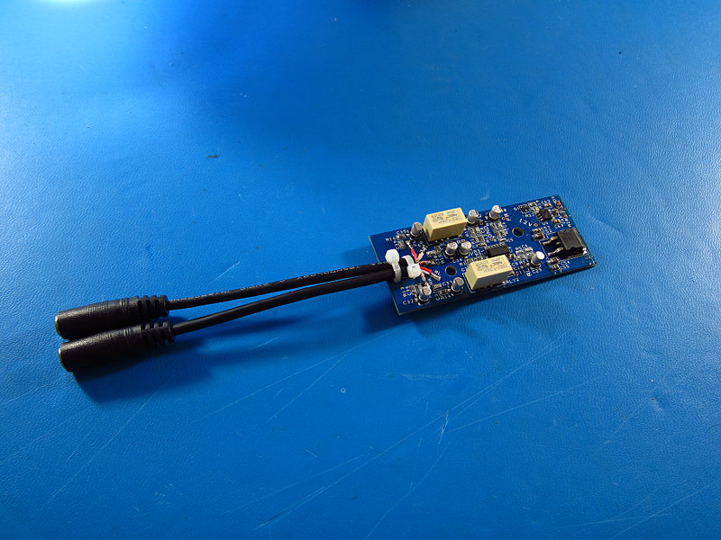

                            I have one of the boards mostly assembled now. Once it's all together I will run a few tests to make sure that things check out. From there, I will have to look into how to do some serious listening tests.
                            Here's my electronics dungeon at home. The Mad Science Man Cave.
                            One assembled board, mostly ready to go. I still need to install the wire leads that will tap into the RMT200 for power and audio signals.

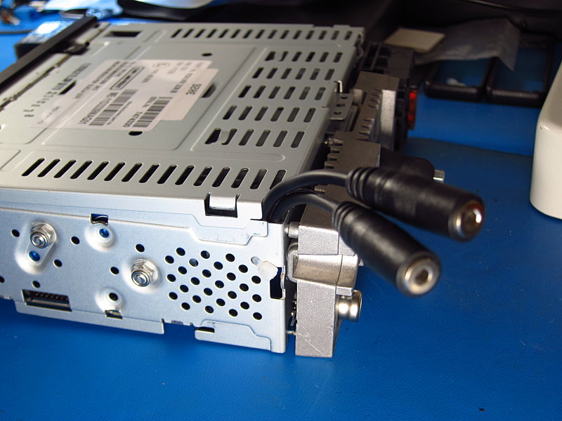

                            The pre-amp signals will be routed out using two 3.5mm stereo jacks. Getting these signals to an amp will be a simple matter of using some stereo 3.5mm to RCA adapter plugs. I originally wanted to run 4 RCA cables out of the HU, but there was no good way to do it: it would have either required some cheap thin RCA wires with minimal shielding, or beefy shielded RCA cables and some heavy cutting on the radio chassis. In this case, I bought a variety of different 3.5mm cable ends and these ones have pretty good shielding in them while still fitting out of the chassis with only some very minor Dremel cutting needed.

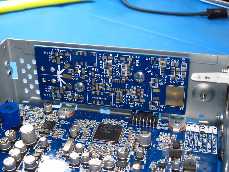

                            Here is how the board sits in the unit. It almost looks like it belongs there!
                            Clearance to the optical drive unit is good too.
                            As I mentioned above, there aren't many cable routing options in this thing. The rectangular gap in the rear corner where these wires come out will need a few millimeters of cutting with a Dremel. Installation in the dash will probably take a little bit of finesse (and tilting of the HU), but it should work out just fine like this. You can also see the outside of the board's mounting hardware. It's all 18-8 stainless hardware with nylon ring lock washers to ensure that everything stays put.
                            Note that in this photo the top lid had not been trimmed yet, which is why it doesn't look like it fits.
