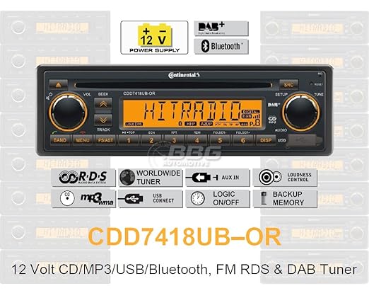

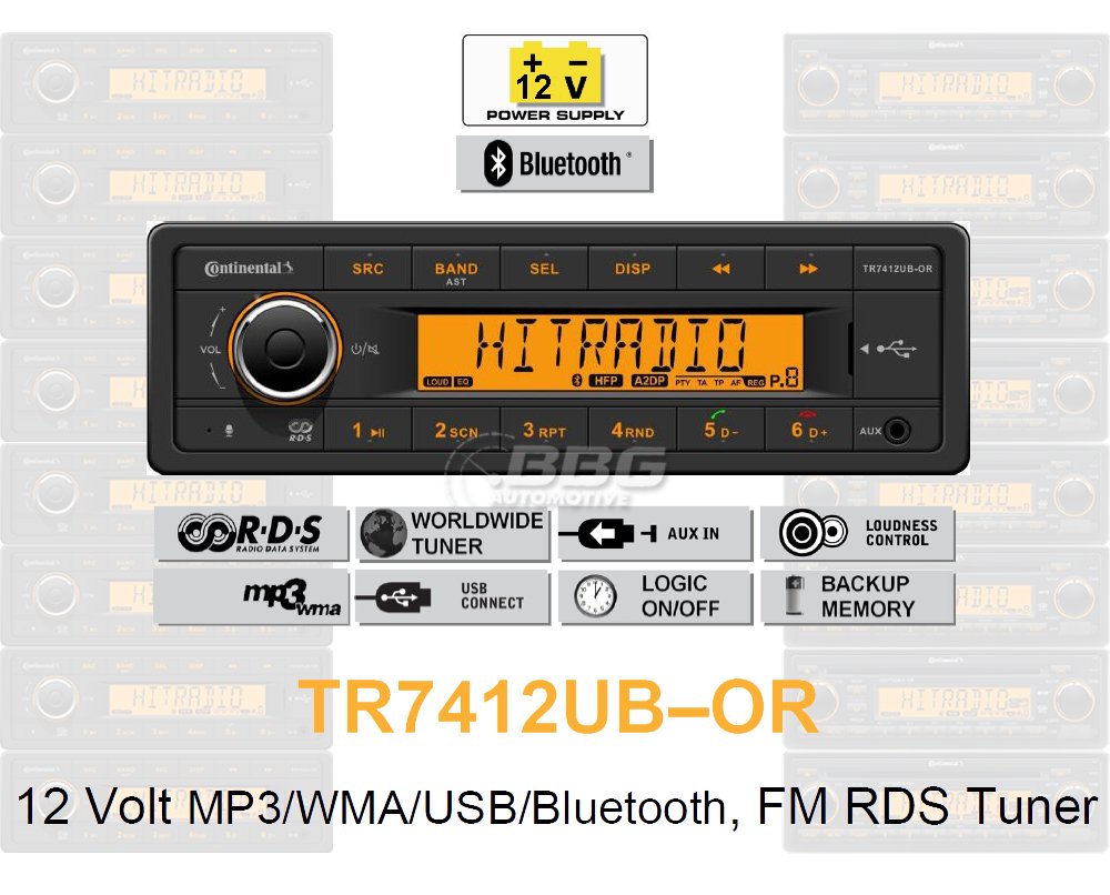

Wonder if this is similar to the RTM200 -
But on another topic
I have a VDO/Continental with ISO inputs, how did you get your power antenna working?
It looks very similiar to your clarion unit but without the CD function.
In my radio, there was all of the circuitry for the switched 12V output and even a dedicated pin for it. There was just one little component missing which would connect the internally switched 12V signal to that pin, so I bought one of those components and installed it. Bam, working 12V output.
As Luke mentioned, there might be a switched 5V output or something like that. You can buy small signal relays that can be activated with a 5V signal, and then use that to switch a live 12V signal from elsewhere in the wire harness.
Brickwhite, if you are willing to open up your unit and take some good macro pictures of the PCB, I might be able to tell you if there is anything available to enable a switched 12V output.Comment
