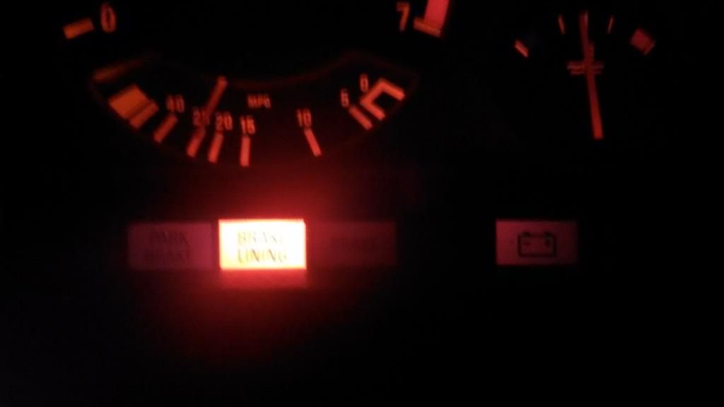

                      This picture was taken at cruising speed at 2500 RPM.
                      1989 635csi - Betty White - 5-Speed, 120k, AWII over Natur Nappa
