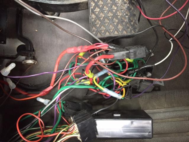

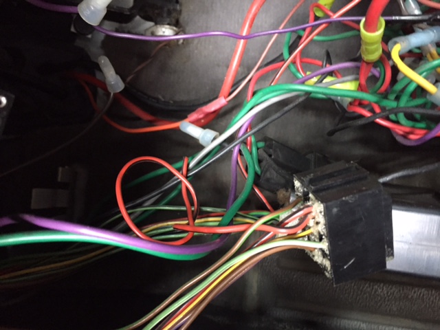

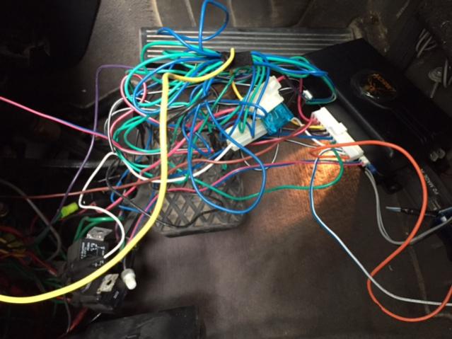

    Sooooo yesterday I pulled down the cover under the steering wheel and cam into this mess, his aftermarket alarm that was wired like a 5 year old. I pulled it out but I still have a mess of stuff behind that I am not sure what is stock and not. I also dont know how these relays are supposed to mount since I dont think BMW just had them laying in there.

      Yea, I am not sure what that big red wire is thats going through the firewall, I have to trace it. Ugggg I bought the car because body wise it was in super good shape, just two small rust spots, but I think I would rather deal with rust then electrical right now.
        If it's not a daily driver... I would pull the dash and start from scratch. That's just me. It looks like hell in there. I wish you the best of luck.
          Its not, its our 4th car and is basically sitting as a project car right now. I do plan on pulling the dash eventually to put a new one in.

                  I can search Google all day long for under the dash wiring images, but nothing I found was close up like you need. If I were back home in the states I would take some detailed pictures for you. Unfortunately I am half way across the world.
                    PO ran a wire to the head-liner cause he thought he was going to pick up the "door open" trigger for his alarm there. Not a good place. Ya pick that up in the door jam, frame side.
                    I wouldn't be surprised if that alarm was installed by a "pro" that has been doing it for years. A lot of those stereo guys cut corners where you'll never see it. They need to move cars, and you'll never see it, so why not right? (frustrating I know)
                    My advice - is to learn to read the ETM manual. Pictures are never going to tell you what-is-what. It's like me showing you a post card of NYC and telling you what subway to take. You need a map - It's all in the ETM.

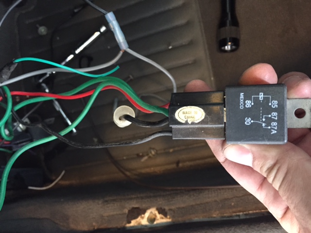

                      Thanks, I started looking at that, and it will help with the wiring, I am just curious to how those relays were mounted, I cant imagine they were just laying there.
                        Why find a mounting point? That takes time! Time is money! Crimp it, shove it, and forget about it!
                        BTW, usually the supper thick wires are for a "starter kill" - so, be careful removing them.
                          True, although I am tryng to do it right, I am anal like that :) Anyone who has ever bought one of my old cars knows that everything works perfectly and is pretty up to speck when you get it if not better. But I hear ya, its a consideration.
                            I used to install alarms and remote starts. The industry is nuts with how much many will just hack together. That does not look like a factory relay to me, but Im no expert. My guess is that is may be a starter kill relay with a power wire run directly to the battery. Looks like a viper alarm. Take it slow, and trace all the wires. It sucks, but it is what it is. I hated doing alarms and remote starts because it was more about how many you could do in 1 day, sacrificing quality.
                              I know your pain op...my coupe looks similar under the steering wheel...years of aftermarket bs being installed...take it slow.
