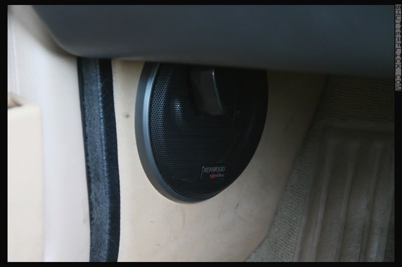

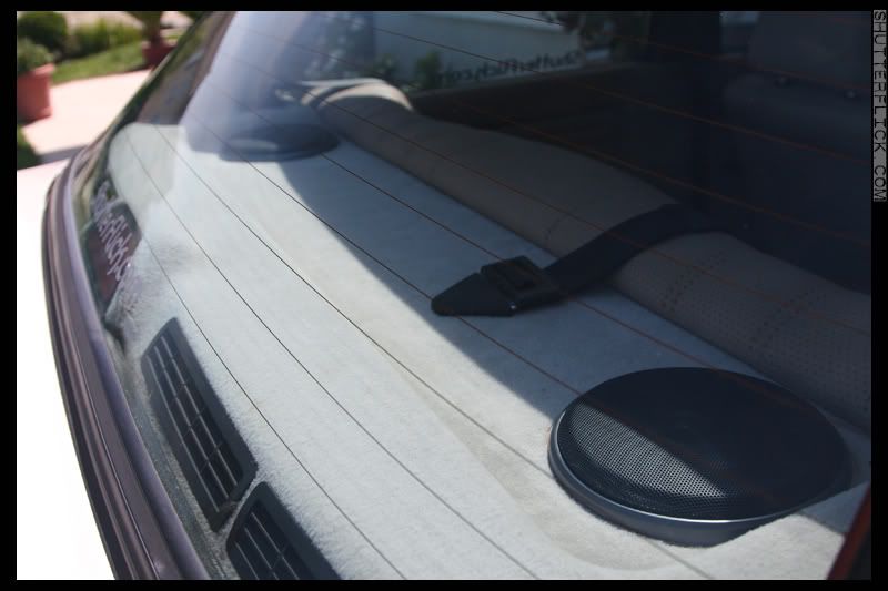

      Sony Xplod Specialty Series (cdxf605x) head unit and 5 1/4" Kenwood eXcelon's all around.

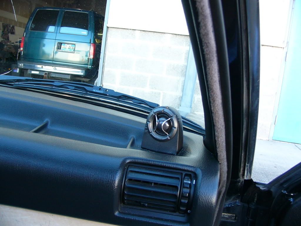

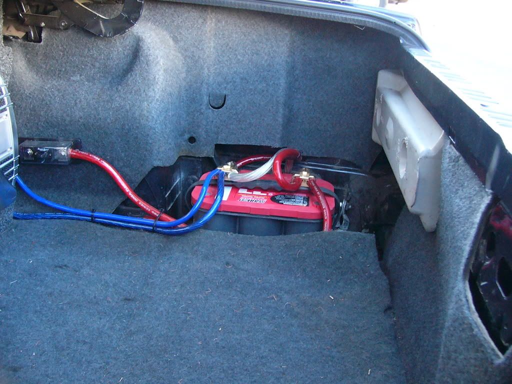

        So here is some oddness:
        So much to do. The battery is going to get a new power run, I have Monster 0 gauge. I have a second Optima redtop for under the hood, with really cool battery terminals. Haven't even mounted the rear one yet. I am also adding a 1.2 farad cap behind the Optima.
        Amps, sub and speakers are all Exile. I used XTec 65's up front, running off of a 600.4 in triamp mode. I will be adding a AudioControl EQX to handle all the crossover functions soon.
        Bass is a Exile XP 12, SVC, 4 ohm, running off of a 600.2. The cabinet is 2.4 cubic feet, tuned at 32Hz, using 2) 4" AreoPorts, as seen on the rear deck.
        I have been building things for this in my spare time, hoping I was gonna be ready for show quality (not one bit of this is show quality, except the sound) by the PNW Picnic a few weeks ago. Instead, I hustled to get sound for the drive...so this shit is ugly as hell.
        I am going to build a complete new dashboard eventually. The speakers will integrate into the new dash, higher than they are now, and angled in towards the center of the car.

                How do you like you're set up in terms of bass? Ive been thinking of running something similar but can't decide if I want to include a sub or just run four speakers off an amp.

                  Luke that is a nice build up other than the tweets on the dash. I am just not a big fan of that but all the other is awesome.

                    It sounds pretty good, I would do the four channel if I wanted more bass. Im not a big audio buff, though.
