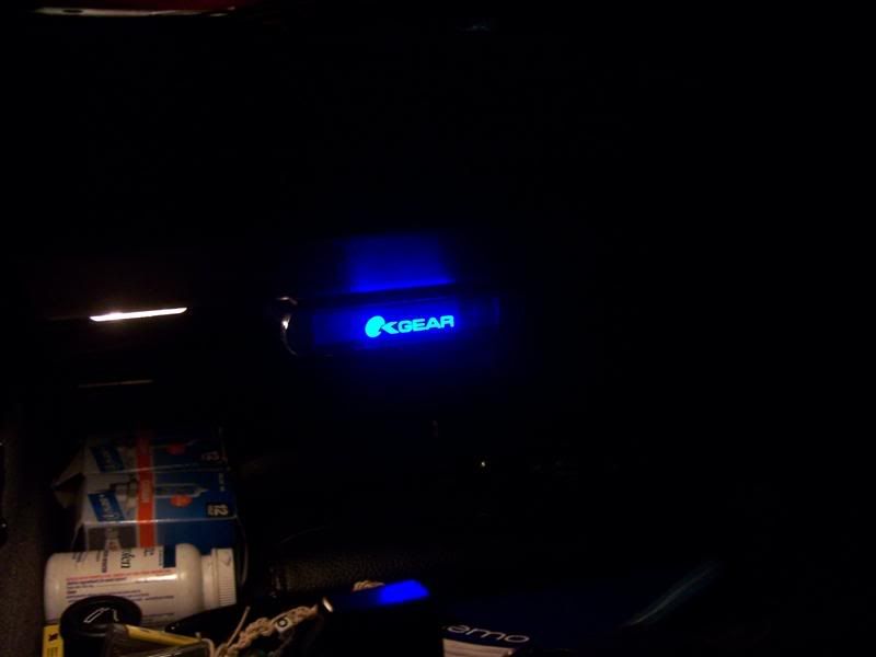

    Here's mine. Tweeters... are tweeters for now. I'm going to front mount them soon to prevent the problems grills create for high frequency. Rear speakers are some Pioneers I've had for awhile (very low gain, just for rear passengers). The subwoofer is removable by the release of the clamp for ease of using the pass-through.
    Hard drive in my glove box plugged into the kenwood

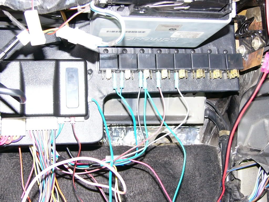

            I have not yet Dynamatted the doors, as I have not yet decided if I am going to shave the handles, or just the locks.
            I am still finishing the alarm on the E30, so I have not yet driven it with the Dynamat. Sure seems quieter just driving it back and forth from the parking lot to the shop...
            Alarm:

              Just a few relays. Planning ahead?

                No shit... What are all of the relays for?

                  8 relays total.
                  2 for door locks
                  1 for domelight control
                  1 for Hood release
                  1 for Horn Honk
                  3 for Retained Accessory Power (isolated) for windows and radio.

                            You need one for the dome light? And hood release? Got something custom planned? And why do you need a relay for honk? Doesn't the alarm system have one built in?
                              Domelight Surveillance is where the alarm turns your inside lights on for 1 minute or until you turn the key on when you disarm/unlock
                              Originally posted by NitroRustlerDriver
                              And hood release?
                              Yeah, I have a Honda starter solenoid mounted underhood with a cable going to the hood latch...just not quite enough torque yet. Might have to do block and tackle, or find a beefier solenoid.
                              Me? Never.
                              No, the horn honk output is a 500mA output, and since I have to run the horn directly (as I want to keep it "key on") I need a relay.
                              It is finally all done, with the exception of hood pop and motorized trunklid. I just do not like that the remote start turn the stereo on when running on remote start...so I am going to re-engineer the "Retained Accessory Power" setup. It also runs the windows, so that is even nicer IMO.

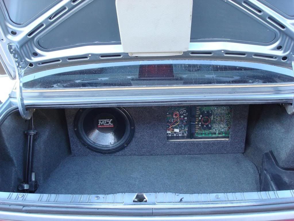

                                just threw this together with some stuff i had laying around. fosgate 501x 4 channel amp. alpine v12 2 channel amp (250 watt i think) mtx 4000 12" sub.
                                Had an avic n1 but someone really wanted it. I think i'm gonnah get the alpine ida-x001 ipod unit. also have some boston aqoustic rallye series compononets that i've been holding on to for about 10 years. still nib
