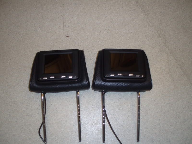

    TV's in the head rest
    I know alot of you are going to say it does not go with the E30 look ..
    But I did it for my kids so they can watch tv when we go for a spin...
    I am almost done with them ....Pics soon to follow..

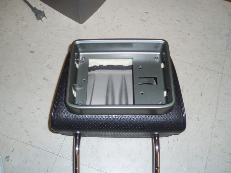

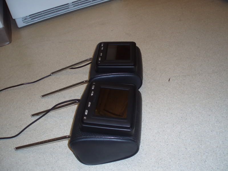

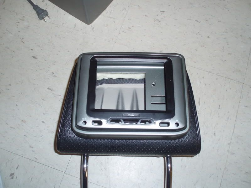

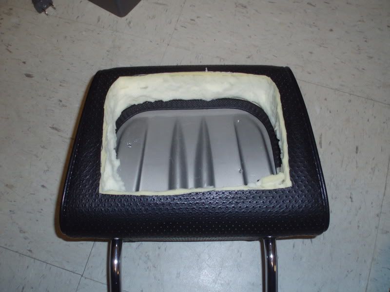

    DIY
    1. Cut outthe middle of the headrest
    2 check for fit
    3. test fit the tv and get it ready for painting to match headrest I am going to use flat blak paint
    4. I took the tv's appart to paint them flat black

      Damn, man, that is a shame you didn't talk to me about this first.
      You should have left the vinyl more intact than that, basically cutting an "X" in it, then cutting the foam, then gluing the vinyl in place, punching hole to run wire, screwing in, etc.
      Of course, I have done about 100 headrests over the last few years. Personally, I don't like HR monitors, but whiskey-tango-foxtrot...it ain't my car.

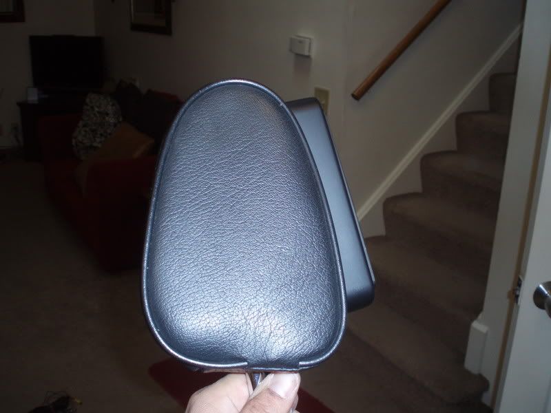

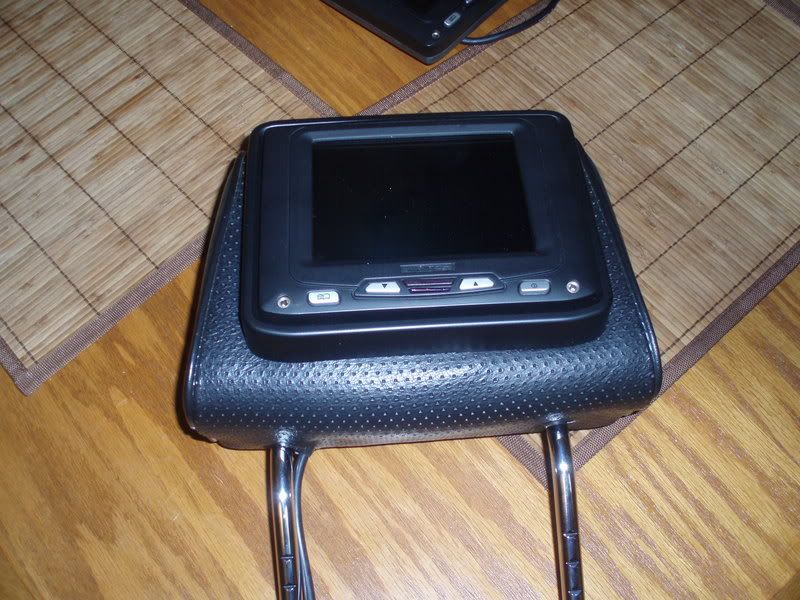

        all finish

          I will only use them when the Boys want to go for a ride other than that I have my other set to put back in place ......thanks for all the Comments .......
