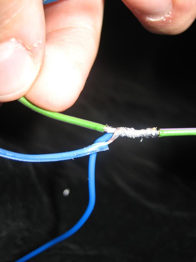

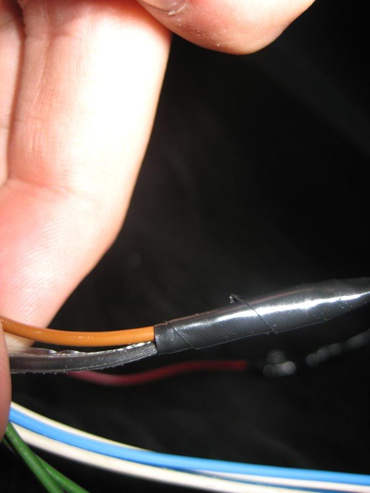

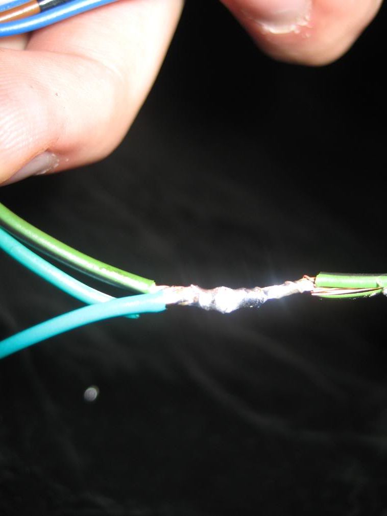

  • devonjordan
    replied
    Yeah, i picked one of these up for about 25 shipped, and have to say it is awesome. Keyless entry, I love it!
    Anyway, i took some pics of my wiring, because I know it would have helped me a lot.
    Blue, Blue, Green/Purple
    Green, Green, Green/Black
    Black, Brown
    I hit my antenna up for some power, just ran some 16 gauge to the red, so this is red, red.
    This is super easy, DO IT!
