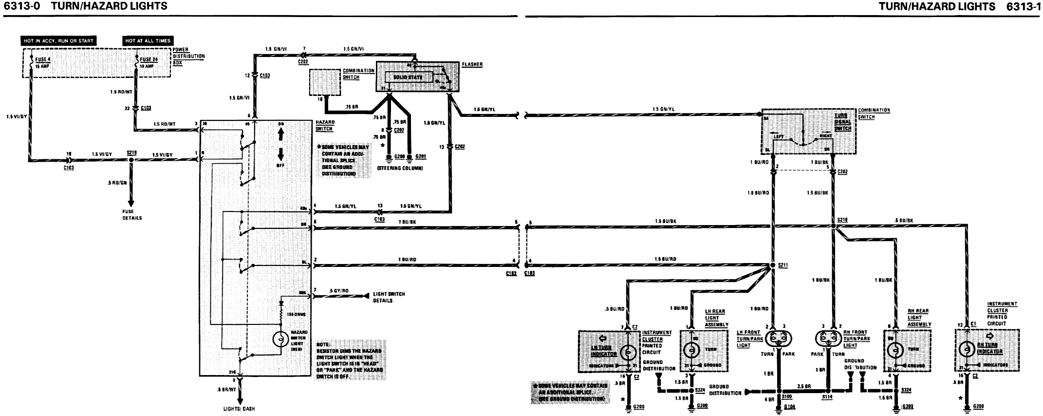

    Here's the full diagram which concerns the turn signals. The blinking is controlled by the flasher module (in the steering column, makes the clicking noise), and the only way that I can see you ending up with a one-sided issue like this is if there is an issue with the bulbs on one side, or the turn stalk itself. I know that if there is too little current (burned out bulb) it will flash fast, so I am not sure if it will stick on if there is "too much" current, but I'd guess that maybe there is a short somewhere. Anyway, the diagram should at least give you an idea of what's what.
    (full size image in link)
