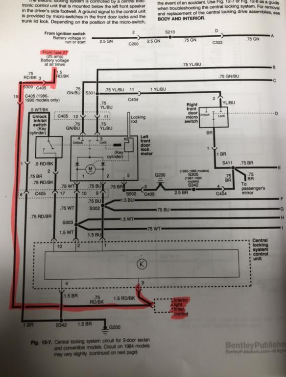

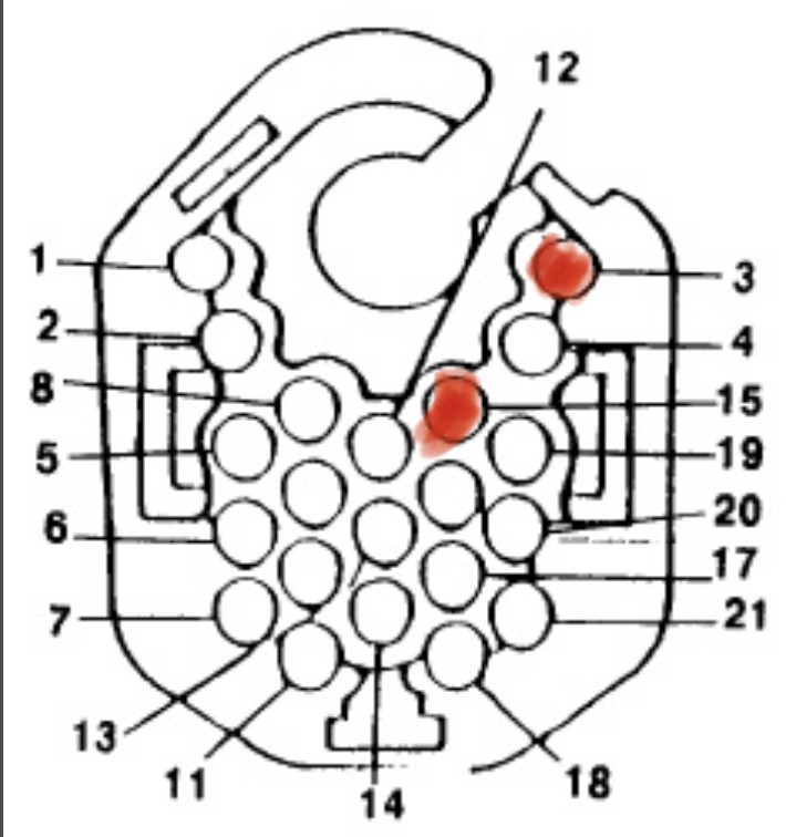

    My diver side door lock is not functioning. After some digging, I popped off the driver side speaker and found that the #3 and #15 pin connector wires were cut. After digging on the internet and the Bentley manual, it seems I need to run these wires to the 27 fuse and the other to the central locking system. Anybody had this experience?

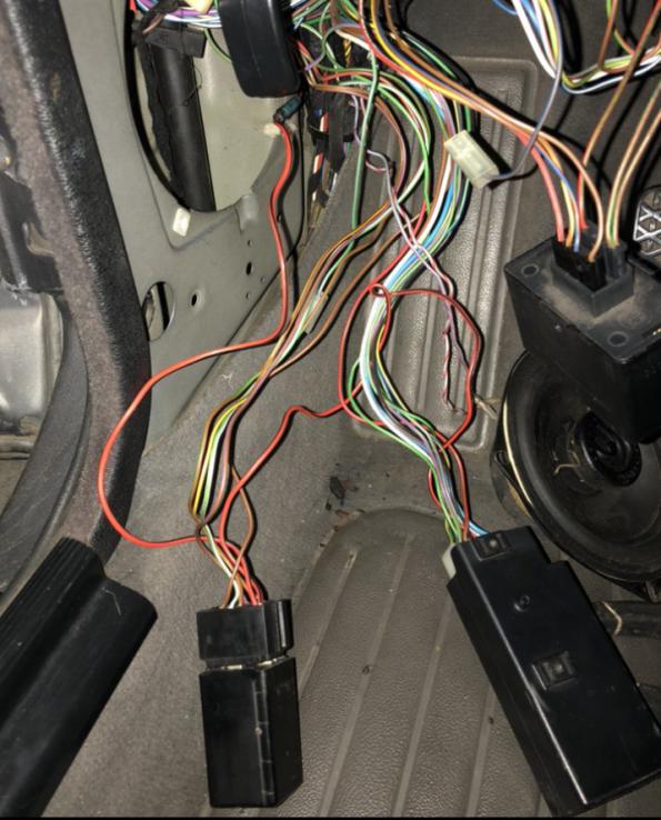

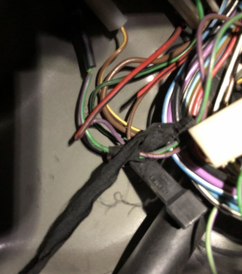

    Pic of the pins which were cut. Driver side door only opens from trunk.

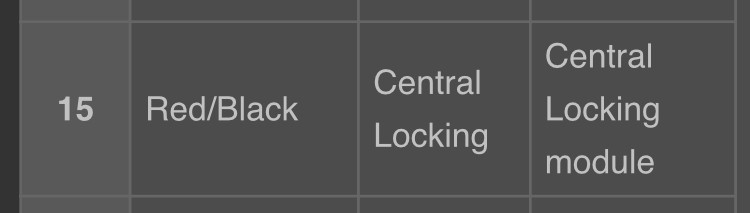

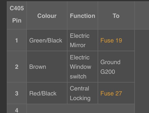

      I found this.

        Are they just cut, and can be spliced back on to the rest of the wires, or were the rest of the wires completely removed?

          I think someone cut and spliced, eliminating the redundant wire going to the door. The link https://www.rtsauto.com/two-of-most-...w-to-fix-them/ shows how to do it. It has been done but I think the actuator is broken. I pulled the door panel and did the trick where I removed the battery cable and then reattached it to the battery and the actuator didn't make a clicking noise as it should as directed in the Haynes manual. This leads me to believe the actuator is shot. But the trunk is the only way I can open the driver's door and the actuator still works but just from the trunk.
