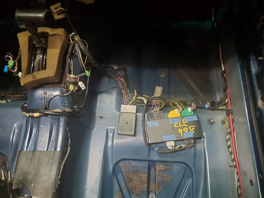

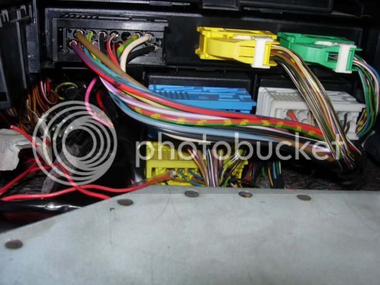

The GM4 has 5 connectors (X10182, X13252, X13253, X13254, and X13255), and the RMIV has one (X13258). The pin assignments are as follows with those associated with the window functions highlighted:
The E30 cuts power to the window circuit during cranking via unloader relay 5 which provides power only in run. If we get power from this circuit as is, the windows will not function as intended when the doors open. The E36 GM4 receives a start signal to cut power during cranking, so unloader relay 5 is no longer needed. Pull the relay and put a jumper wire in place to provide constant power to the window circuit.
Whereas the E30 has a single 30 A circuit for all four windows, the E36 uses two 30 A circuits. Since I’ll never use the cigarette lighter for more than USB charging, I grabbed power for the rear window GMIV from there. It may not be necessary, but I took the added precaution because I don’t think the E30 electrical system was designed with the idea of operating all four windows simultaneously.
Power and ground for the window switch illumination comes from the ashtray bulb wires. All grounds are connected to the unused window switch grounds. You must run dedicated wires to the front doors for the hall effect sensors (power, signal, and ground). You must also create a separate circuit for each door jamb switch. As they are wired in the E30, the two door jamb switches are connected to the dome light ground. If you tap into this for your door open signal, both windows will drop when you open the driver door and stay down until the dome light timer goes out. The driver side switch has two terminals, the second being for the seatbelt warning and door chime. I unplugged that wire and connect the GM4 to the switch. The passenger side switch only has one terminal so I replaced it with a driver side switch and connected the second terminal to the GM4.
I didn’t document which wire I connected for the rear windows. I wired all of the window motors with the system powered so I could confirm polarity. I suggest doing the same before you make any of the connections permanent. I cut all of the E30 window switch connectors off and soldered all wires. You may wish to retain the connectors and use some type of spade connector. I also cut the connectors off of the E30 window motors and wired them to the E36 connectors.

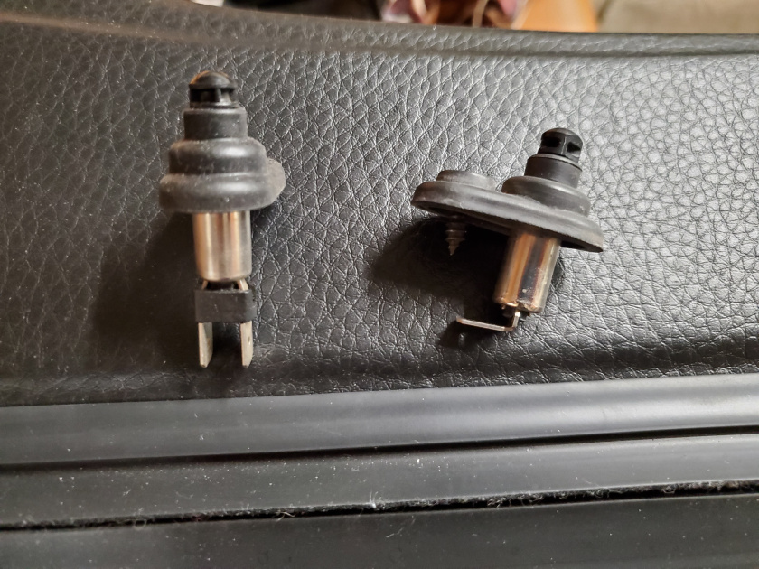

- E30 driver’s side door jamb switch (PN 61311370805)

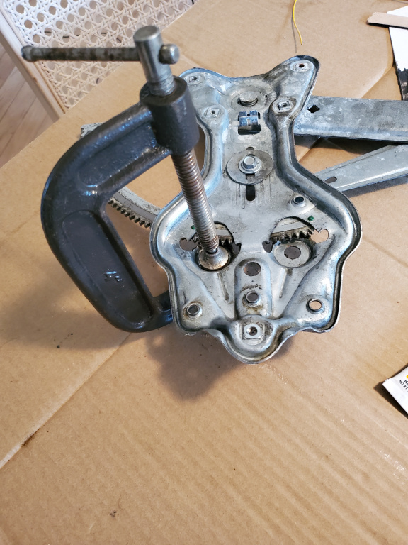

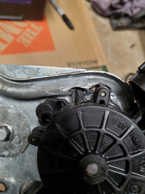

The motors share the same mounting points and outside dimensions and position of the drive gear but there are differences which necessitate modification of the E30 regulators. While the E30 has a floating drive gear, the E36 has an extended gear shaft supported by a bushing in the regulator. The E36 motor’s gear housing is weaker and may flex without this support causing the mechanism to jam. I cut the bushing mount out of the E36 regulators and epoxied them onto my E30 regulators. They could also probably be welded but I don't have a machine. The E36 motor also interferes with the E30 regulator in three places so the regulators must be ground to provide clearance.
