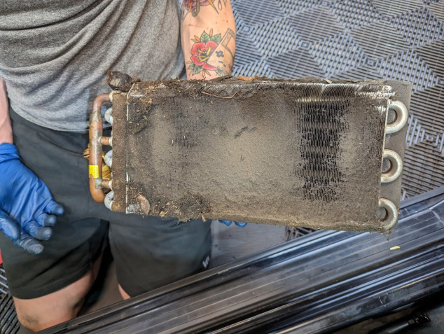

    I've searched tirelessly on forums, Google and the Bentley manual and thus far have been unsuccessful in finding a definitive answer to my question. I was able to remove the A/C evap core in my vert, but not without damaging the fins. I knew I would be replacing it, so wasn't too worried about removal. However, I'm trying to find the best way to install the new one without damaging the fins. I found 1 thread where a poster referenced the issue with evap core removal in his vert (more difficult due to clearance issues caused by battery tray location in engine bay), but I think he ended up just flushing his in place.

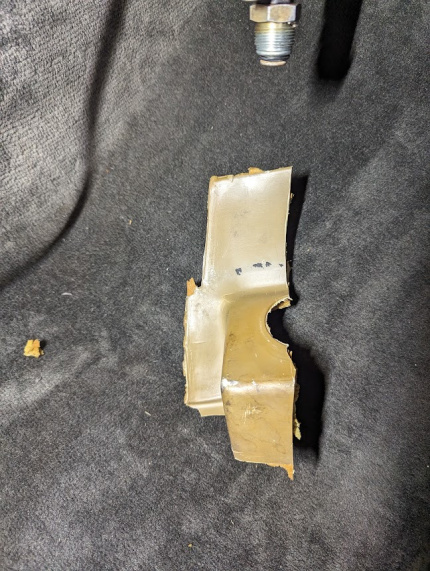

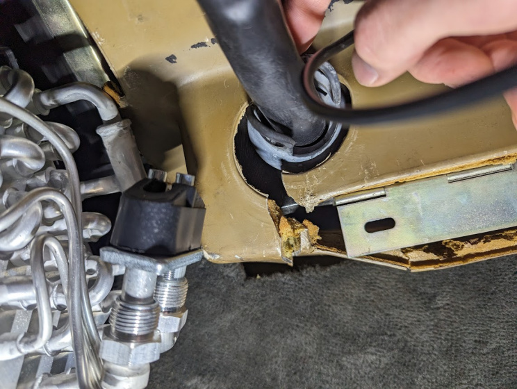

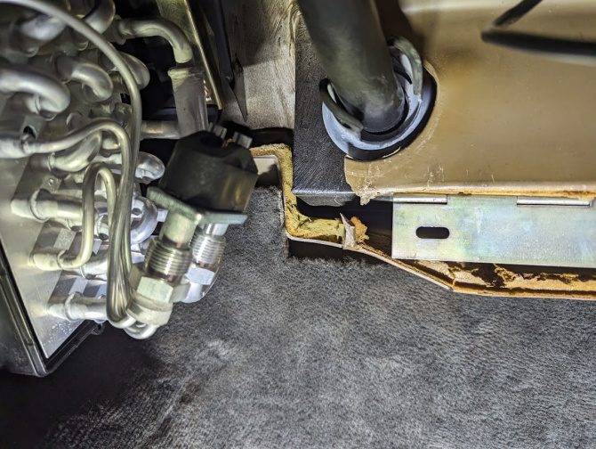

      Thank you for the reply, ZeKahr. I value your input, even though it wasn't the answer I was hoping for. With this newfound knowledge, I proceeded to remove a small section of the brown insulation from the lower left corner of the interior battery tray mount. I unplugged the harness in order to push it out of the way and make room for the new core, while a friend carefully slid it into place. Fortunately, there was minimal resistance during the process and I think basically no damage to any fins. I understand that cutting the padding/insulation is not the ideal solution, but considering the circumstances, I was willing to accept this outcome. The removed piece holds itself in place but I'll add some adhesive for peace of mind when reinstalling and don't it won't cause any issues since it is completely hidden from view. Hopefully this helps a future vert owner looking to take on this project.
