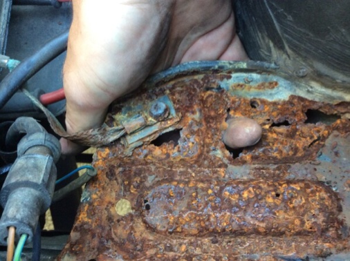

    Convertible owners - post your battery tray
    So mine is full of rust! How bad is everyone else's? Does anyone run the rubber battery vent cable somewhere under the car?

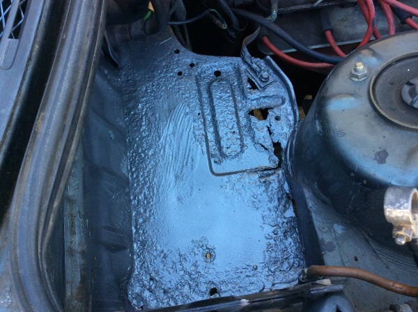

    Is the battery front mounted in the convertible?
    Here's the front tray in my 318i. It's a CA car so this is the only rust.
    It's eating through the shock tower also.
    I want to rear mount the battery when I get the chance.

        My front battery tray had a little bit of rust, but it was easily dispatched with a wire wheel and touch-up paint.
        IMO it's best to move your battery to the rear. You get to ditch that large weighted damper (saving 40-50lbs) and get better weight distribution.
