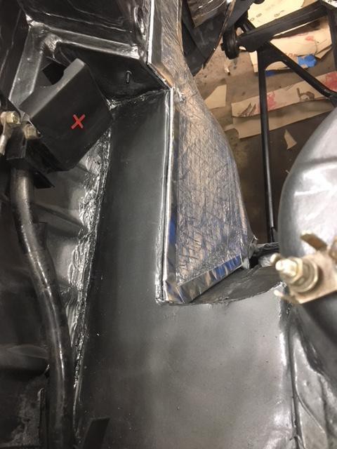

                Here's mine.. the clueless first owners had a battery leak and never cleaned and neutralized the spill. I sanded and wire brushed the tray, gave it three coats of epoxy primer from a Spray Maxx two part rattle can followed by three coats of brush-on Randolph Aerospace Acid Proof battery box paint from Aircraft Spruce. Here is the result...

                  Now there's a man who takes pride in his battery tray. Nicest one I've ever seen :)

                    Thanks, Jeff! With this as my retirement project I can take the time to do things right...hence my purchase of your seat shocks a few weeks back!
