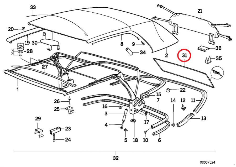

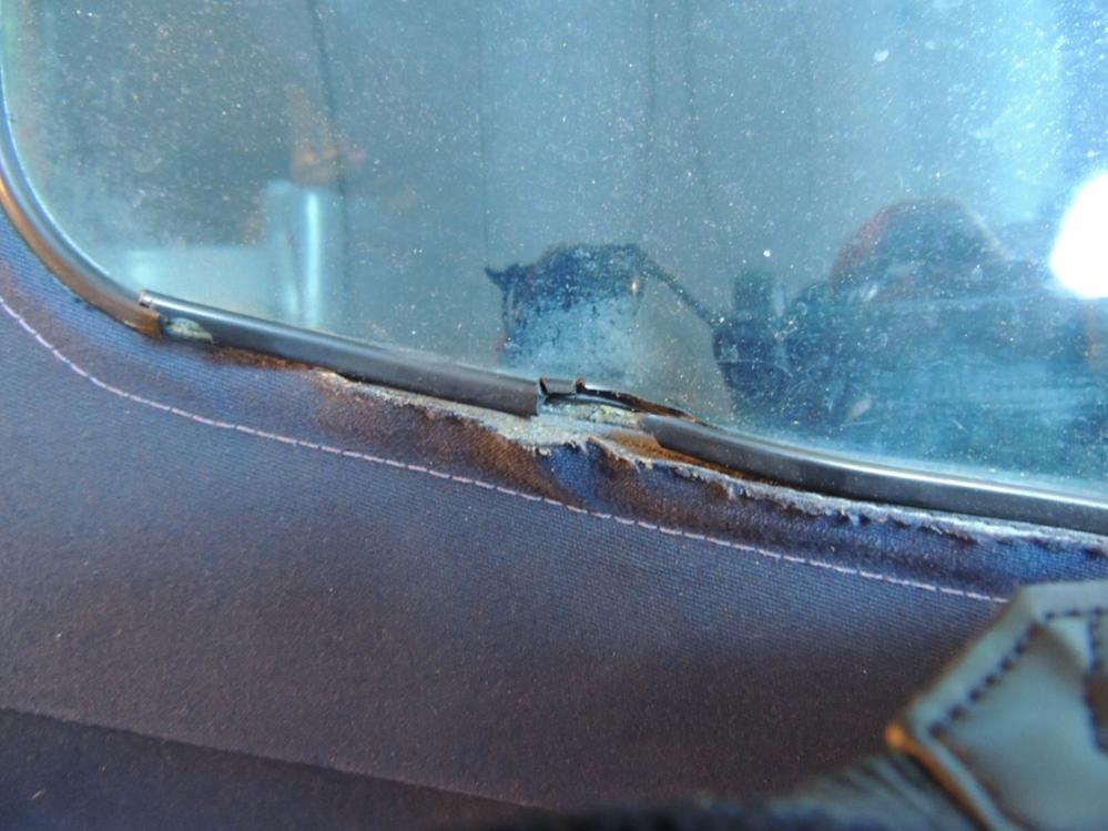

          Is the rubber trim piece part of the window or is it separate? The part that the cloth of the top tucks in under. My top is fine but, the rubber trim piece is all cracked and I have a small hole in the window itself.

            the trim piece you're asking about is separate

              So the trim piece needs to be glued to the window and then the top glued under it? That sounds like lots of fun. Real OEM doesn't show the trim piece so is it included with the window, either if purchased from a dealer or aftermarket? Just looks sloppy to me without the fabric of the top neatly tucked into the trim piece as originally designed.

                No if you look at the picture you posted you can see it's glued to the top after. The emiata window doesn't come with it. However you can probably find some non-oem way to make one at the hardware store

                  So, if it is glued to the original top, which mine is, where would I buy that channel? It's not shown on real OEM. And to be perfectly honest, the top, IMHO, would not be installed properly without this. Maybe this is already glued on an original factory window? Anyone on here know if that is the case. Seems that if this piece were easily available the aftermarket window suppliers would include it with their windows or at least offer it as an option.

                    It's flimsy and has a channel where it clips onto the top fabric outlining the window. I didn't reinstall mine when I installed my new window. Needs an adhesive all round to stay put and I figured it might make more of a mess than anything.

                      ^ yeah it's like a C-channel. There's a slot going down it where it slips over the perimeter of the fabric.
                      I believe the top would have come with it installed. I couldn't find a separate part number for it. Realoem is wrong sometimes but it makes more sense that something as insignificant as that would just be included with the top, especially considering that the top already has lots of other parts which could be separated in the same manner as this piece
                      I didn't reuse mine because it was split etc and I don't really miss it. I'm not taking my car to a concours any time soon. You might have to get creative with a replacement.
