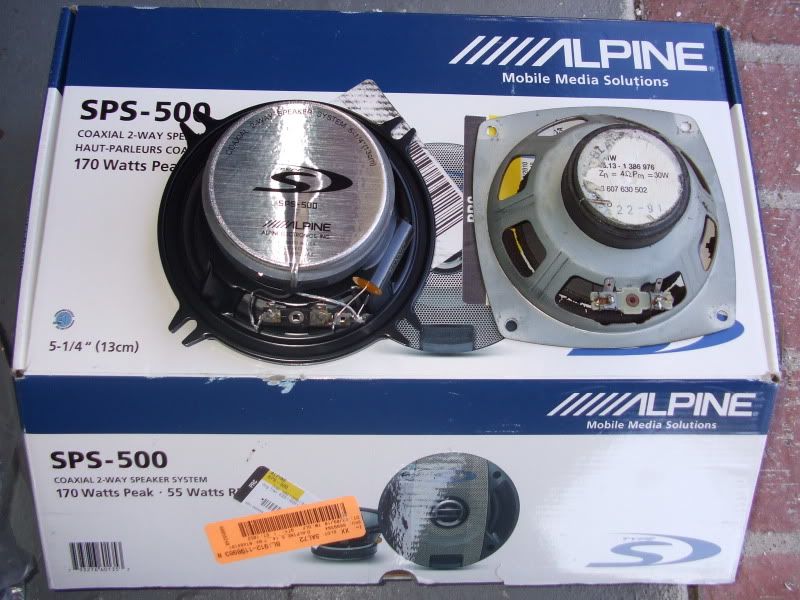

    You need a shallow mid with a smaller magnet. It's fine for fill especially if you have a sub. Here's what I used and it barely fits but does fit without the tweeter protruding thru the plastic panel. I've been very happy with them.
