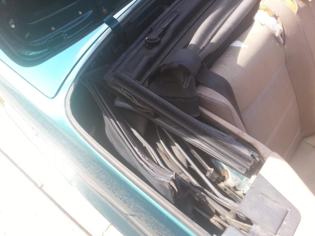

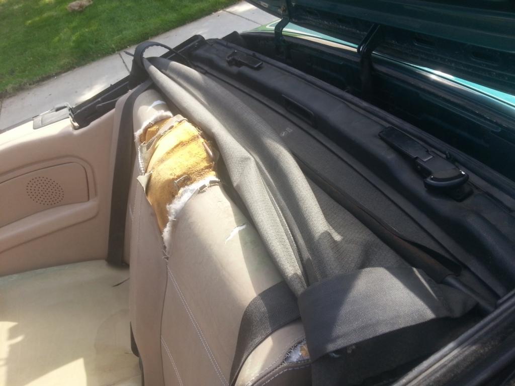

    This vert has an automatic top that doesn't work, so I assumed that you could get the top down manually anyway like I could with my old vert.
    It's annoying to have to shoulder the tonneau cover, but I can get the top down, but these straps are keeping me from stowing it safely. Any idea what might be the reason?

    Lift the top about 18 inches. Push the straps and the fabric to the rear so they "invert" - they will kind of fold in. The fabric will fold easier, make the straps do the same thing. Then it should go into the compartment. At least, this is what happens to a manual with old straps.

      Your straps lost their elasticity, you'll need to make that folks manually from now on most likely.
        Do what this guy said.

          Thanks guys! I guess I'm gonna need new tension straps at some point, but first, the torn up window.

                              I hold the top vertical, flip the bar and push in, then I carefully flip and stuff that part of the top that is bulging out above the bar and the straps in (0:35 mark in video) and then lower the top down and store it.
                              Everything stows away nicely using this method, but if you can't envision the "flip & stuff" step I'll try to remember to make a video when I have an extra set of hands to help me out.
