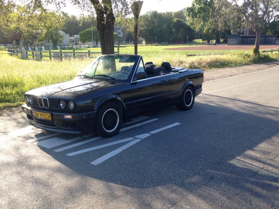

    I did Bilstein sports and BavAuto springs on my vert. It rides nice and it's perfect height IMO. Not stock but not super low either. They sell the set on BavAuto for just under $700 if I remember correctly.
    Pic for reference:
    Sent from my SAMSUNG-SM-N910A using Tapatalk

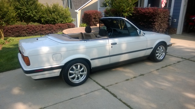

                    I have h&r sport oe grays, and bilstein hds. A friend has the same Springs but bilstein sports. His rides about half an inch lower, but I love my height. Here's mine.
                    Edit: forgot I have 195/60/14 tires and m3 offset cabs.

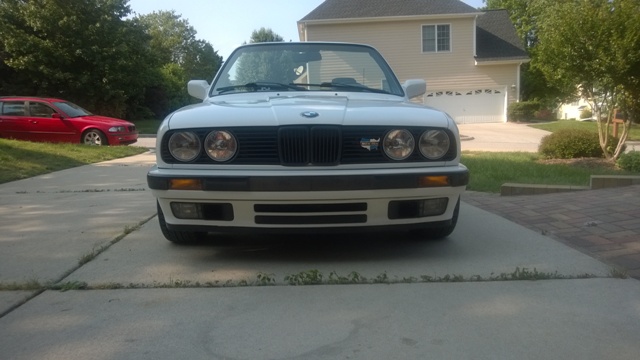

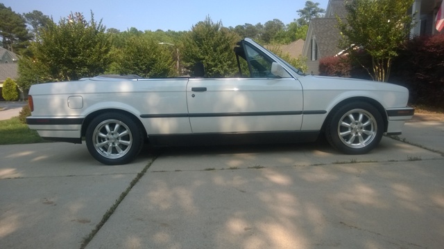

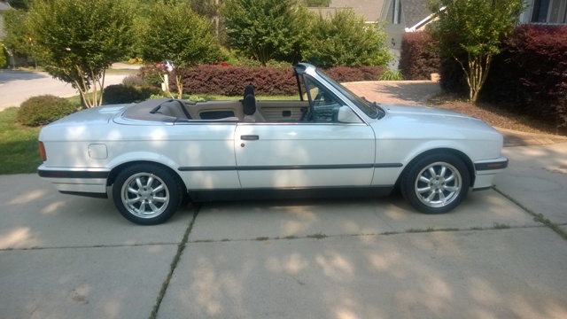

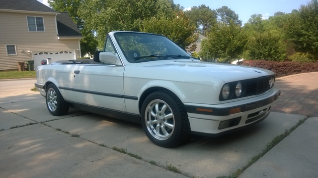

                              Finally finished up the winter suspension project with new rims & tires. H&R cabrio springs and Bilstein Sports with Konig Rewind rims and BFGoodrich G-Force Sport Comp-2 size 195/55-15" Also installed poly front control arm bushings, poly rear swing arm bushings. New poly rear carrier bushings with a poly differential busing. New E30 M3 front and rear sway bars with the front attachment point moved to the strut. Car drives fantastic. See the pictures
