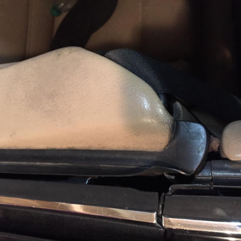

                          Weather stripping
                          I need this piece on both sides, but cant tell if its the same in the parts illustration. Does anyone know if this piece with the flat curved end is available ?
                          • cory58
                            • 1021
                            I've never bought any of these pieces for my vert, but I think part #7 in the RealOEM link in the OP is the part you are looking for. Maybe someone who's replaced those pieces can verify.

                            • jeffnhiscars
                              • Jun 2011
                              • 6010
                              read my post #13....again
