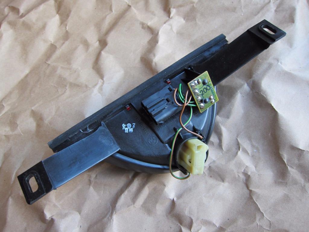

    The rubber gasket under the trunk mounted 3rd brake dries up, shrinks, and lets water in. This exposes the little green circuit board inside the unit to moisture, and it fails. The 'Check' light flashes on the instrument cluster, because stepping on the brake pedal doesn't send the acknowledgment to the ECU that the brake lights are working OK. The 'Brake Lights' warning light is also lit on the overhead panel, even though the 3rd brake light works fine.
    That's annoying, but not annoying enough to pay over $200 for a new 3rd brake assembly (PN 63251386147).
    One rumored fix to solving the blinking 'Check' light is to the remove the green board from the circuit and connect the +/- wires leading into it. Haven't tried that, but it sounds a bit hokey.
    If you buy a used 3rd brake light, it'll probably have the same problem as the one that's giving your grief. If not, it will soon.
    Got to thinking of another idea - Can I find that green circuit board inside of a coupe or sedan's 3rd brake light assembly and transplant it into my vert's assembly? Chances are good it's been dry since installed at the factory, so it should be working OK.
    Has anyone ever tried this?

    So I don't know the answer, but let's say it can swap. If the leak from the gasket killed your old circuit board, won't it kill your new one? You need a new gasket first, no? Can't get one without buying the whole assembly. Or are you planning to make one?

      If make one or try to seal the assembly with RTV.

          Nah, can't buy just the gasket, not for my late model anyway. I was thinking of using RTV between the red plastic piece and the remains of the rubber gasket, not directly on the paint.
          http://www.realoem.com/bmw/enUS/show...diagId=63_0204
          Mine is just toast, so I will probably need to suck it up and spring for new unit. Here's the inside. The edge of the gasket has even separated. Flyboyx, maybe I should shop for a used assembly from the Houston area LOL :D

            It appears that late model non-convertible E30's DO have the chip. I think it's a safe bet that the chip can be transplanted to a vert assembly to give it extended life. Check out part number 63251385187 from a 1990 coupe.

              Yours isn't that bad. You can reseal that easily. I would find another vert board as that is the correct part. I have a couple spares.

                  How To: Coupe 3rd Brake Check Chip into Vert Transplant Procedure
                  Ok, so this weekend I confirmed that you CAN indeed transplant the 3rd brake light check chip from a late model coupe or sedan into the 3rd brake light housing on a late model convertible 3rd brake light housing in order to stop the check engine light flashing and to turn off the overhead check panel light for Brake Lights(!).
                  Before you do this, though, confirm the symptoms:
                  1) Is your check engine light flashing even after you step on the brake pedal after starting the car?
                  2) Is your Brake Lights(!) warning light on?
                  3) Do all your brake lights work when you step on the brake pedal?
                  If all answers are 'Yes', then you need to take a look at the insides of your trunk-mounted third brake light (remove tool tray, then 6 or 7 screws fastening the housing to the trunk). There's a chip in the housing that communicates with the ECU and let's in know that it's present and functioning properly. Water and dirt get into the 3rd brake housing and corrode that chip. If it looks like this in there, you probably need to replace that chip.
                  Rather than blow $200+ on a new convertible 3rd brake light unit, or buying a used one potentially with the same problems, go to eBay or your local junkyard, and buy a 3rd brake light unit for about $25 or less that lived its entire life inside a nice dry coupe or sedan.
                  You can cut the chip from the coupe/sedan unit and solder it into the vert unit.
                  *Snip Snip* Be sure to leave as much wire on the chip as possible.
                  Solder the new one in place of the old decayed chip. Clip one wire off the original chip at a time to BE SURE that you get your connections right (2 green, 2 brown)
                  All connections completed!
                  I sealed up all the many many cracks in the red plastic with clear silicone caulking and installed a new Osram bulb before putting it all back together.
                  And added a couple drops of silicone to hold the chip in place and buttoned it all up.
                  After this, I started up the car, saw the flashing 'Check Engine' light, stepped on the brake pedal, and the CHECK ENGINE LIGHT TURNED OFF with no lights on the overhead warning panel! Awesome.
                  This looks like a lot of work, but that's just because I added so many pics. The whole operation took me about an hour to do.

                      I did a bypass on my Cabrio chip and it worked for a while but this seems like a better solution, especially since the 3rd brake light really has no value (well had no value before this post lol)

                        Did the check engine light continue to flash after the delete? I assume not...
                        I didn't want to have to fill the hole left where the wires go thru the trunk lid, so I needed to properly fix the bastard.

                            No check lights at all. I connected the 2 black wires with green stripes together
