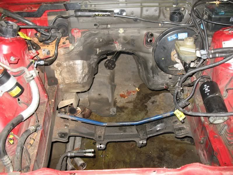

      • e30rapidic
        • 2167
        should be right here, just like all other non M e30's
