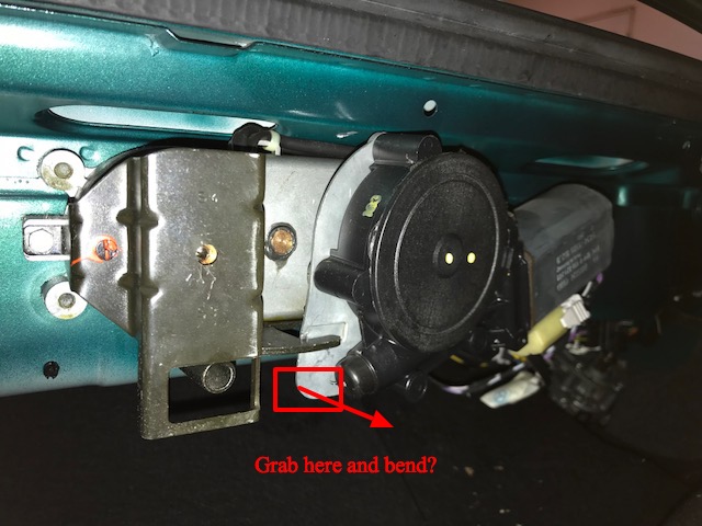

    Originally posted by Dspill
    Thank you very much for the advice. I want to make sure I understand your comment "I was able to take some material to protect the plate along with gripping the area of it that connects to the emergency release catch with vice-grips and bend it back a mm or two so the catch held the motor in place more firmly. "
    The "material" noted above was to keep from damaging the plate and then grab and bend the corner below 1 or 2mm toward the back of the car which will push the gear toward the front when fully latched in-place?
    Close. I did the bending here..., and in the same direction you indicate. Just enough that the emergency release catch there pulls a little harder and engages the motor a bit more positively. It isn't a big bend, and it won't latch properly if you go too far.

  • Dspill
    replied

    One of the weak point to the design of the auto top power mechanism is the emergency release design. There is a flat mounting plate for the motor that is attached to the release catch. This plate slightly deforms over time a tiny bit. The meshing of the motor's drive gear and the locking mechanism has such tight tolerances that even a mm or two deformation can cause poor engagement of the drive gear.
    My guess is the ratcheting you heard was the drive gear slipping. When it slips, it can't get to the stop point or at least hold at the stop point to perform a proper "lock". I had this happen on my top as well. Scared the hell out of me because I thought I had lost the motor worm gear or other issues I had seen people talk about that required the replacement of the assembly or conversion to manual.
    Here is what I did. I was able to take some material to protect the plate along with gripping the area of it that connects to the emergency release catch with vice-grips and bend it back a mm or two so the catch held the motor in place more firmly. Then I had to perform the part of the realignment procedure where I held the tonneau cover in the stop "lock" position with the allen key, and while holding, then reengaged the drive motor. It's tricky, but I did that a year ago after exactly what you describe happened to me and I've never heard another peep out of it.
