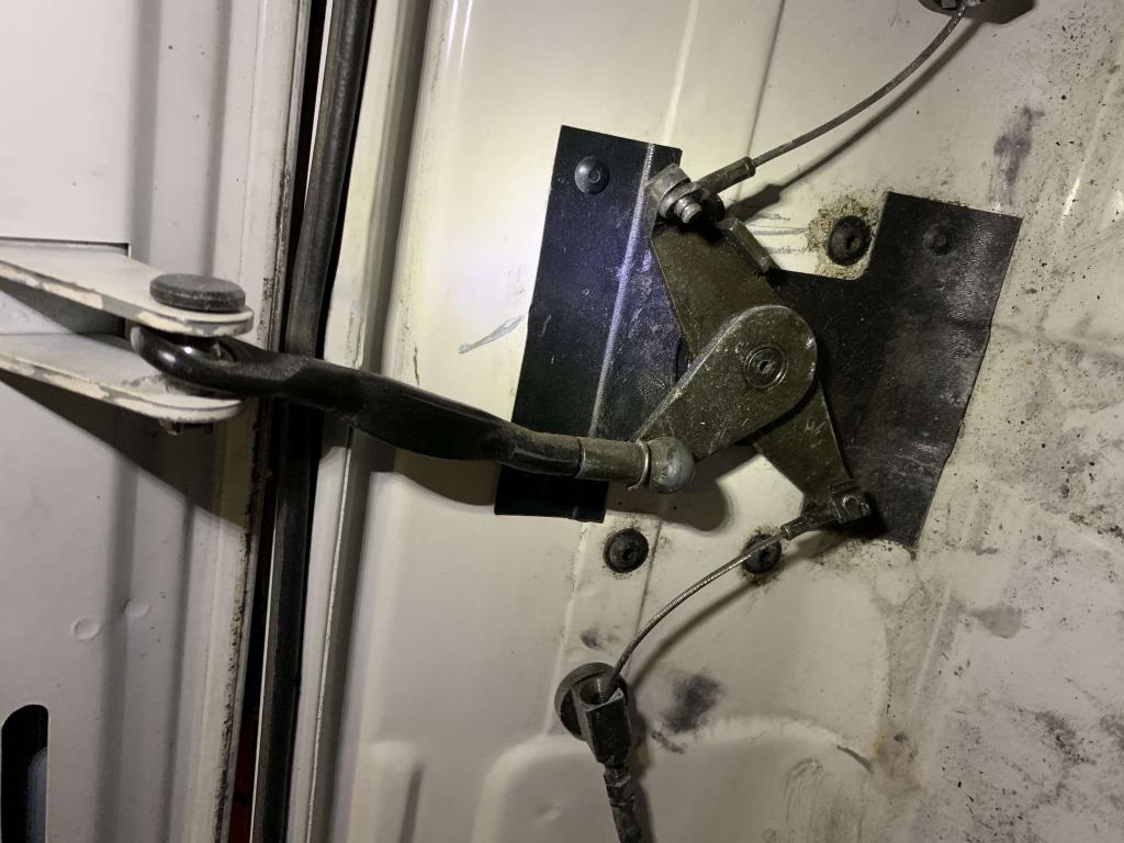

    Sounds like you had a linkage come loose. No way to help without some pics of the mechanism in the center of the top compartment/tonneau

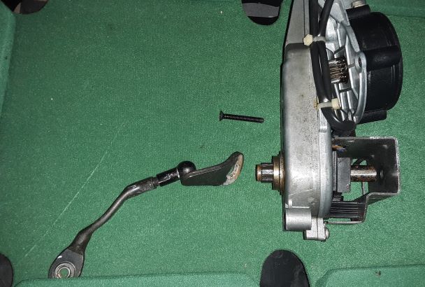

        Here's the mechanism

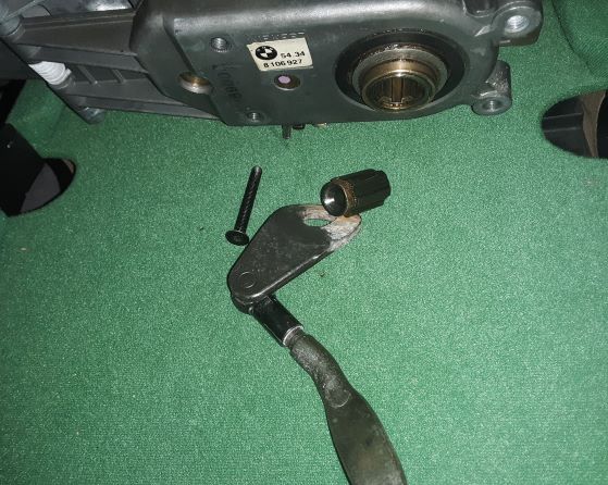

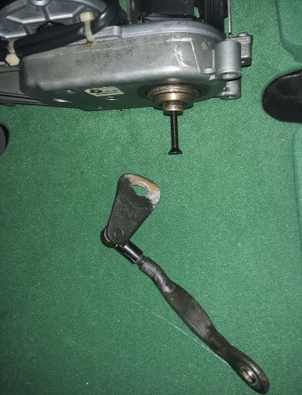

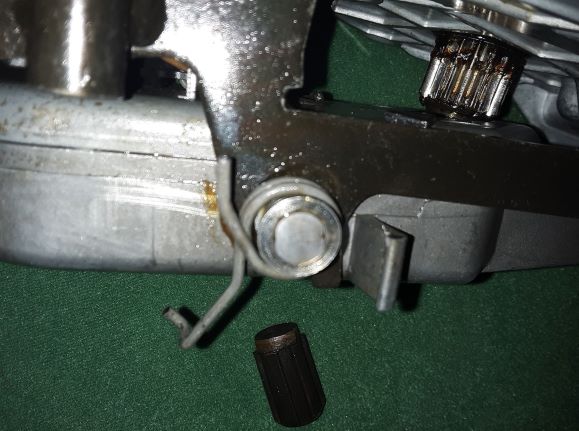

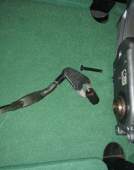

            Possible but gears don't usually strips to the point you experienced, without making grinding noise prior. There is a little spring that keeps tension between motor plate and gear assembly, may became loose and caused separation. You can pull the top section of trunk lining and inspect lid motor. Another possibility, there is a small lever which attaches to the motor drive and the linkage bradnic mentioned, that fails some times. part no. is 51258112682. May not be your case but happens.
