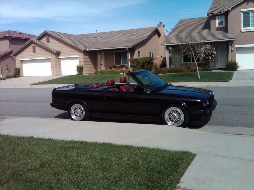

  • 5ickride
    replied
    1991 318ic
    Refreshing the suspension and getting it lowered.
    Bilstein Sports and HR Cabrio springs with 15mm drop hats. Running 15x8.5 F, 15x9 R which will need some fender rolling i suppose.
    I'm curious if i'll need to go lower that this to pull off my wheels. If so, and keeping the HR springs, what other options do I have to go lower? Remove pads?
    Thanks

  • robrez
    replied
    ^^^ Looking good Tim. Once you get that front lip on, you need to do a proper photoshoot so we can drool over those BBS RSs.

  • VacMan
    replied
    Updated: H&R Sport (cabrio), Koni Yellows, No spring pads, Eibach sways, M3 CABs, refinished RS003's. A couple impromptu pics. I repainted a new lip so that's why there isn't one in these pics; the old one is on the autoX car now.
