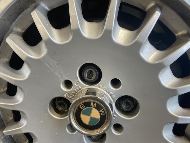

    Lug nut lock
    Has anyone ever had a lock like this on there lug nut? I don’t have the key for it and I’m trying to get the nuts off. Can I just drill through it? Click image for larger version

    Hammer in a cheap old socket then take the nut out.

        12 point socket that's just a tad smaller than the wheel nut. Hammer it on, turn counter clock wise. Done.
