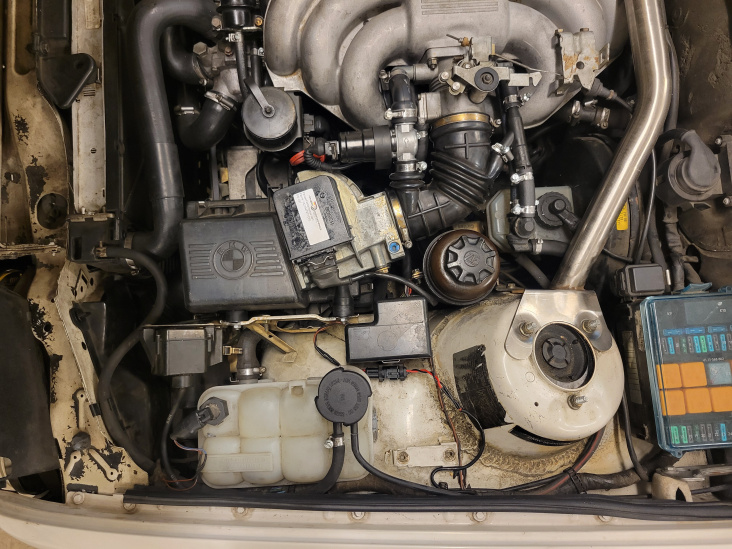

    Have the airbox out and want to put everything back as accurately as possible for posterity.
    Can someone kindly look at the photos and tell me if the coolant hose routing is correct here? If it's not supposed to go thru the little metal half loop piece (circled in magenta), then what the heck is that piece for?!? Just to brace the airbox?
    Also, does anyone have the "distance rubber" installed for their airbox? Is this where it's supposed to go (teal)?
    Thank you.

    Looks right... the airbox has a rubber piece that fits in that half loop(magenta).

      Aha. Both of my questions answered in one fell swoop. I bought the "distance rubber" (teal) and didn't realize I just needed to trim it down to size. My airbox did not have a rubber spacer before, but that's solved now with a section of that rubber material. Teal, meet magenta. Like the old YouTube video :)
      Back in place with all new vaccum hosing, a correct snorkel into the headlamp area, and a fresh Panzer Performance AFM.
