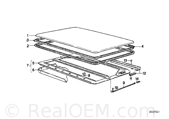

if you see the video youll know what i mean by getting stuck, also theres pictures provided of what i think could be the seal since it is rubbing right on the housing of the sunroof, idk what it could be, if anyone can help me out id appreciate it, thanks
