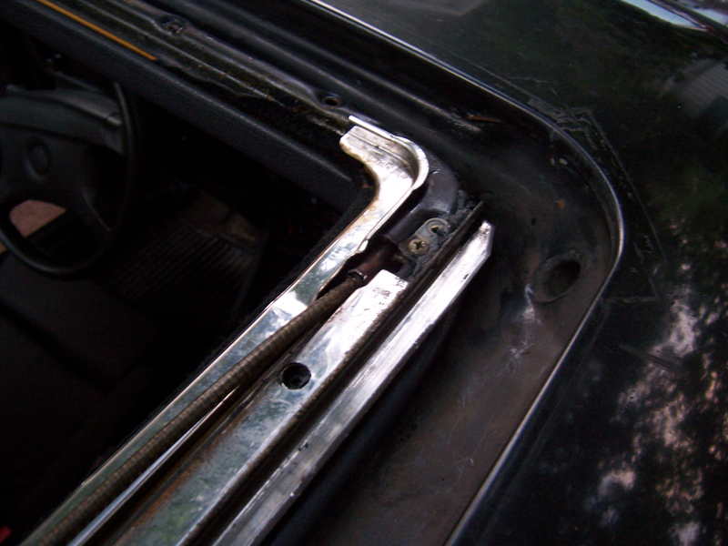

                        Can somebody help me with some tips how to remove the sunroof cables.
                        Was searching the net but can’t really find useful DIY with pictures...
                        I have removed sunroof and all plates i can actually see the cables like here on the picture
                        Question is do I have remove sunroof filler as well?
                        And what does it mean by dropping the motor? I have el. sunroof.
                        Then of course how to put new cables in…?
                        Also can somebody please tell me what stops sunroof when you fully open it? For some reason mine sunroof goes too far back and hits into the roof (leaves scratches on sunroof). I suspect my cables are too sloppy and they but is there any barrier that stops sunroof by going back too much?
                        Thanks
