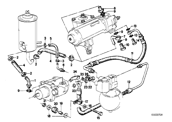

                      • flyboyx
                        • 8371
                        here are the e23 diagrams that real oem lists for an 85 733i. i picked that model and year randomly. any would be fine.
                        Gigitty Gigitty!!!!
                        • flyboyx
                          • 8371
                          and the power steering loop:
                          for some reason, i was thinking that there was a third diagram that i used to put this in order. i will look for it and post if this is indeed the case.
                          Gigitty Gigitty!!!!

                              wowee! you are good with the master cylinder and hyd booster in the photo above.
                              i didn't fool around with any of that stuff you have attached to the spaghetti of brake lines. throw all of that crap away. just screw your e30 brake lines into the master cylinder you have pictured above and you will be in good shape.
                              you are going to need an accumulator. that is the 4 inch round metal softball shaped component. all of your lines run through that. it is pictured in the last 2 photos you posted. i cut that bracket off the donor car and modified it to fit my e30. there are photos of this above.
                              i used the stock s52 hydraulic/power steering pump. you just have to pay attention to the pressure and return lines so they don't get mixed up when you transfer this system to your e30.
                              your top photo shows the abs restrictor so you are good there. also, i was running my setup with an e36 rack, so you should be fine there too.
