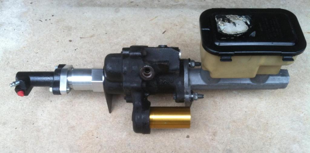

                          the reality is that even though i was successful with this system and it works great, i am not going to use any of this on my s62 swapped car.
                          there is a much better and simpler system out there and it doesn't even need to be mounted to the firewall to work.
                          ladies and gentleman......i give you the remote gm hydroboost system!
                          here is a pic below of what it looks like. it only needs two hoses instead of 7. it doesn't need to be mounted on the firewall. you can even mount it in the trunk if you want to.
                          instead of using the chevy truck master cylinder, i am going to use this part from a 1991 750i.
                          Gigitty Gigitty!!!!

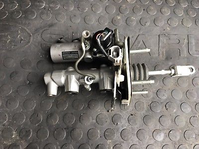

                              I came up with a potentially new idea for a streamlined brake system for the e30.
                              LEXUS RX450H ELECTRIC BRAKE BOOSTER/ MASTER CYLINDER
                              Part #138110-10510
                              I don’t know a lot about this unit, but it appears to be compact and self contained. They can be found on eBay for about 150.00. It seems like it could be a good solution. If one of you ventures to try this out, please post here to let us know if it’s viable.
                              Gigitty Gigitty!!!!

                                That seems like an awesomely simple and compact solution. If it's suitable It might have saved me a lot of hassle. Also weight.
