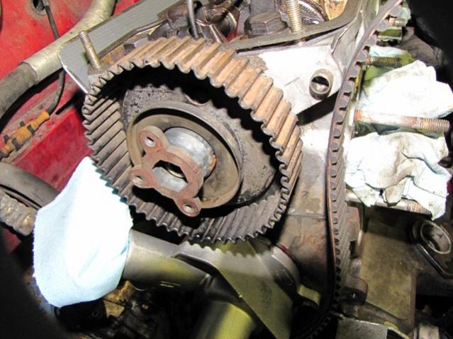

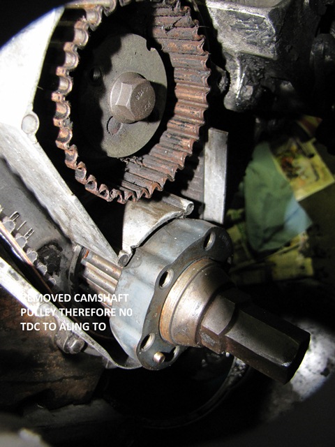

Need major help i'm stuck
My camshaft sprocket does not have the notch in order to align it with the TDC mark on the head.
I'm stuck since i also took out the crankshaft pulley and the lower timing belt cover so i cannot locate the TDC.
Should i just reinstalled everything and then try to find the TDC for the crankshaft and camshaft.
I also forgot to mention that i have not taken the sparkplugs out; therefore cannot turn the camshaft sprocket or crankshaft
Here it is the camshaft sprocket and camshaft area.Last edited by amcink; 04-30-2012, 08:43 PM.Comment

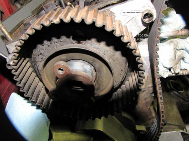

they cam sprocket and crank both have marks they are just super filthy!!!! Clean them up they are there. It is there on all cars your car is no exception.
On the cam sprocket you will see a 1/4 inch arrow on the inside and you will notice on eof the teeth is notched close to the head tdc mark.
the crank wheel same thing its there just not as deeply notched as an I........ just clean.....Comment
