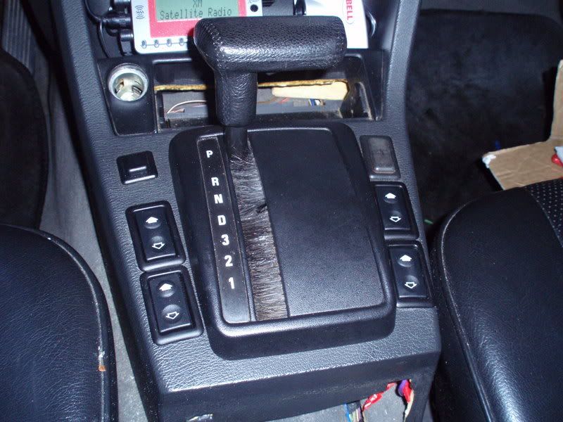

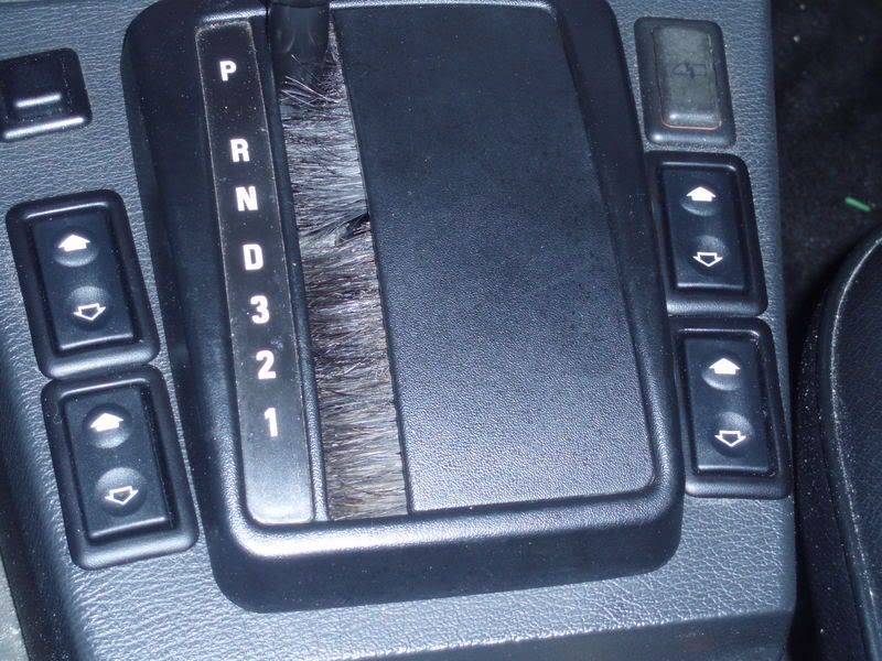

              #186
              ok here are a couple fo shots of the switches one thing there are kind of tight because of where the original holes where but I think they look ok

                  #188
                  thanks again gang yes they all light up

                    Good Job! Looks nice! I put chrome frames on mine, but I think I am going to put the black one I also have back on. I do not want to over bling it.
