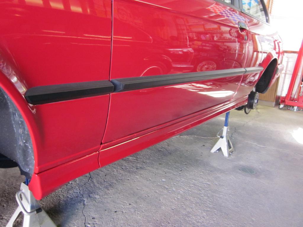

I cleaned the very top most section with acetone and ran the tape the entire length. My skirts have never moved. The tape the way I did it also stops debris from running down and sitting inside the skirts. To help install the tape, apply the tape to the skirts keeping the backing on it then install the skirts with all the plastic clips on the pinch seam at the bottom. Finally gently pull the backing between the skirt and car. Pull down the length of the car while pressing the skirt to the car. Pretty easy. Prep all surfaces first and you'll never have to mess with them again. -
Well gentlemen, I've changed my mind on the 3M double sided trim tape.
When I installed the first skirt on the passenger side, two of the green grommets pulled out of the hole, creating large, ugly gaps-see photo. I don't know if this was because I had painted my rockers with two coats of POR 15 and that made the seating area of the metal thicker or what, but needless to say, it really pissed me off.
Since I had already drilled all the holes on both sides, I went to Home Depot and found some plastic 3/8" plastic hole plugs and used rtv sealer on them and plugged the holes tight on the driver's side, letting it cure overnight. I left the white grommet (fits 5/16" hole in the rearward part of front fender and fits the round white plug) in place, as for some reason it seated well on both sides. That means you still have plugs in the front and the two plastic rivets in the rear wheelwell in place. I cut tape to fit the tabs where the plastic clips previously were, stuck one side in place on the skirt, leaving the protective strip on the other side. I then dry-fitted the skirt with the help of my wife to check fitment and determine where exactly to place the skirt for final installation. This is important--once the tape is stuck, it's stuck! Then it's just a matter of lining it up and pressing it on, again using a helper. Came out perfect and held fine at highway speeds on my way to the Windy City BMWCCA VintageFest last weekend. Now I've just got to redo the passenger side cause that gap is driving me nuts. Hope this helps.

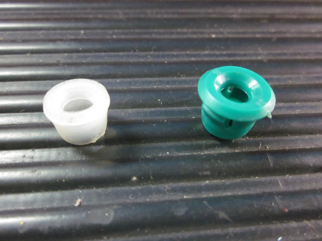

that's a possibility. it was just easier to order all of the same part nos.I realized that you had used 12 of the same green grommets for your install. I bought my skirts and hardware from Blunttech and they sent me 12 of the green ones and 2 of the smaller white grommets for a total of 14. I noticed you skipped one of the plugs, using a total of 12. The o.d. of the white plugs is smaller, which explains them fitting the 5/16" hole, rather than the 3/8" for the green ones. The inside hole looks to be the same however--see photo.
Possibly you were shorted the 2 white grommets?
but you are right that the plug that goes in the white grommet, goes in a little bit tougher than the others.Leave a comment:
Possibly you were shorted the 2 white grommets?Leave a comment:

bernzspeed--An important point I discovered is that the two white grommets that go into the rear of the front fenders are a 5/16" hole, not 3/8" like the green grommets. They're the ones that fit the round white plugs that slide into the slotted piece of the skirt. Luckily, I noticed this while inspecting the parts and hadn't drilled those holes yet, but you may want to update your sticky.Last edited by TrentW; 09-04-2012, 07:57 AM.Leave a comment:
