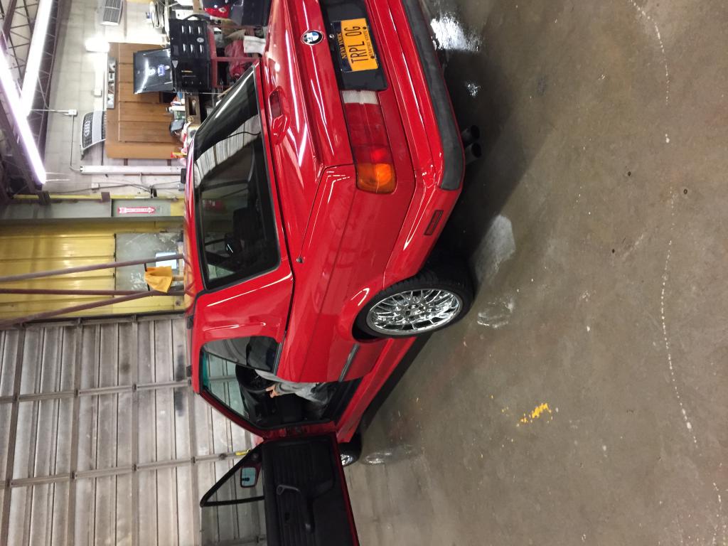

        got my car back today
        got it back from a fresh paint job and had the body shop mount the landing pads for me. he told me it took him 3 mins to do. im sure it would have taken me 3 sun rizes to get them on . heres a pic . its a bit far away but you can zoom in and see them up there. tomorrow ill take close ups

          #64
          not sure why the pic is posting sideways but there it is lol

            #65
            done !!
            So I got the car back from paint today and i mounted the rack I love it!!!

              What big pictures you have. haha
              Looks good though. I dig the painted bumpers and the color matched top too(oddly because i usually don't).

                #67
                I know I apologize about the big pics I have no idea what I'm doing lol. Thank you I'm glad you like it .
