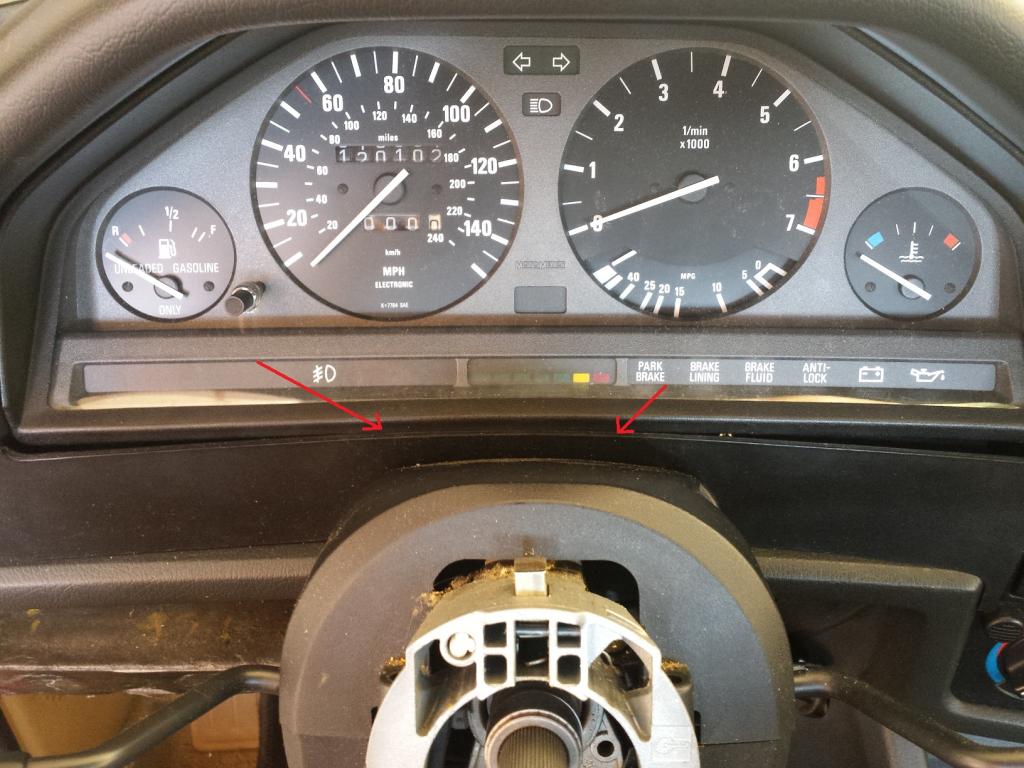

I've run into some issues with the reinstall of cluster I'm wondering if anyone can help with?
I've got the cluster mounted in reverse directions as instructed in reference link, but the cluster and instrument panels do not seem to align correctly?
I'm getting a gap between the cluster and the 2 panels that are supposed to be reinstalled.
Some more pics to show the gap between cluster and panels, it is less than .5" of space.
