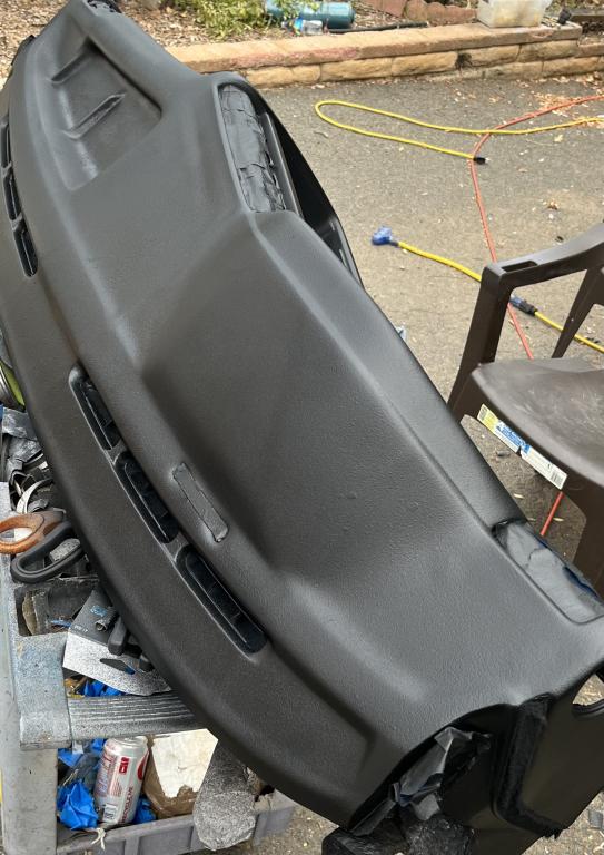

    I followed the same write up on first page. The only thing I did different was use 180 grit sand paper to sand glue. It is how you prep smooth cracks and small bumps on dash. I used primer to see high and lows.

  • e30m3s54turbo
    replied

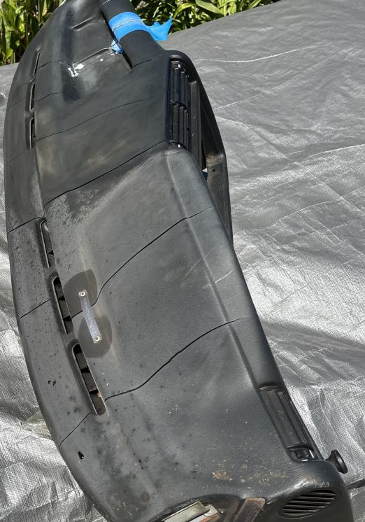

    I had some time to try this on one of my most damaged dash I had to work on. Click image for larger version
