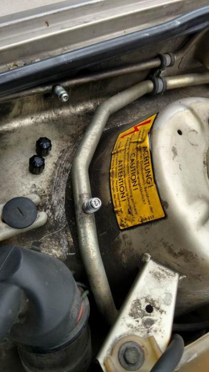

    So my son is having his 86 es converted by a local shop. We're not doing the condenser yet - mostly seeing if the compressor will still work.
    They did the dye thing to check for leaks, and they found it at the pipe that wraps around the passenger shock tower and drops to the compressor. It's the very one in GoldMember's post above and I think it might be part # 64538391051. RealOEM doesn't show a shape anything like this one.
    It has a joint in it from pipe to soft hose - somewhere just above that joint it's leaking, says the tech. I wasn't there - don't know if it's a cracked pipe, or it's coming up from that joint in the hose.
    [ATTACH]109515[/ATTACH]
    That pipe seems to list at $180+ most places. $200, 220. Is that right? Seems pretty steep for a pipe / hose. I don't suppose a small city has those shops that fabricate AC hoses - are those still around?
    Any ideas or suggestions?
    Thanks -
    How about a junkyard or used one on eBay? Or if you DO spend the money, have one made that is r134a compatible (barrier hose).

    VERY useful thread - thanks OP!
    Thanks -
