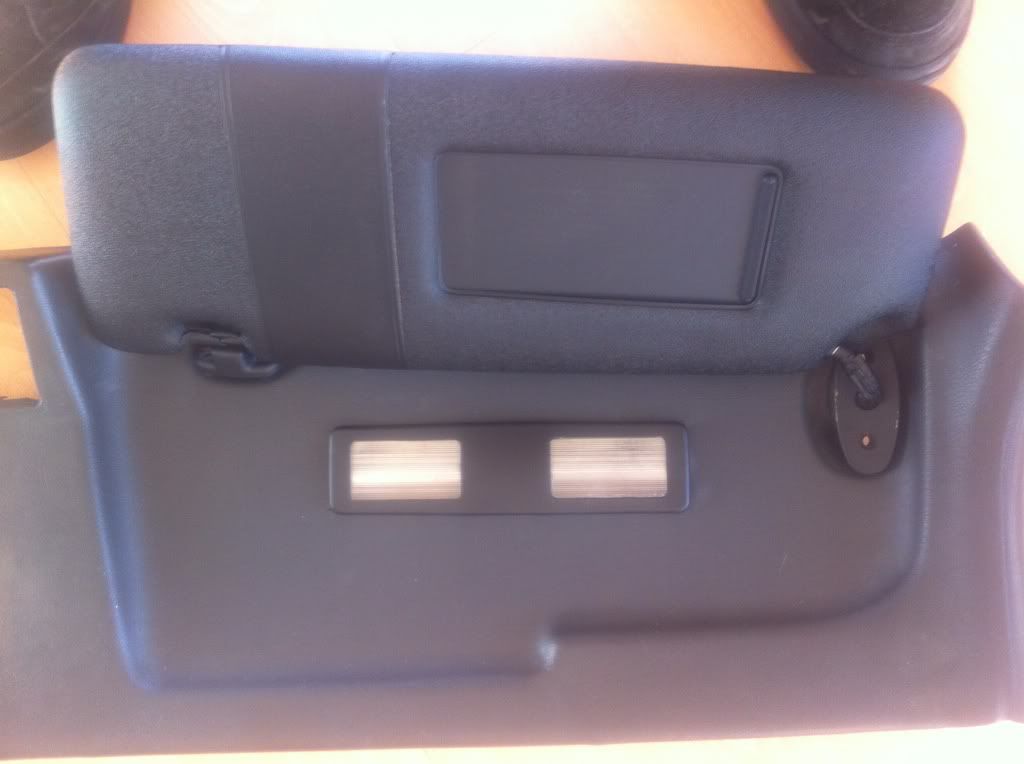

    Been researching for a while on how to change the plain visors e30's have. Finally found a nice decent mod, thought I share. Here's a quick writeup.
    Sorry for the crappy pics/vid
    Things you'll need:
    Dremel/Utility Knife
    Ruler/Lever
    E32 visors with harness and light.

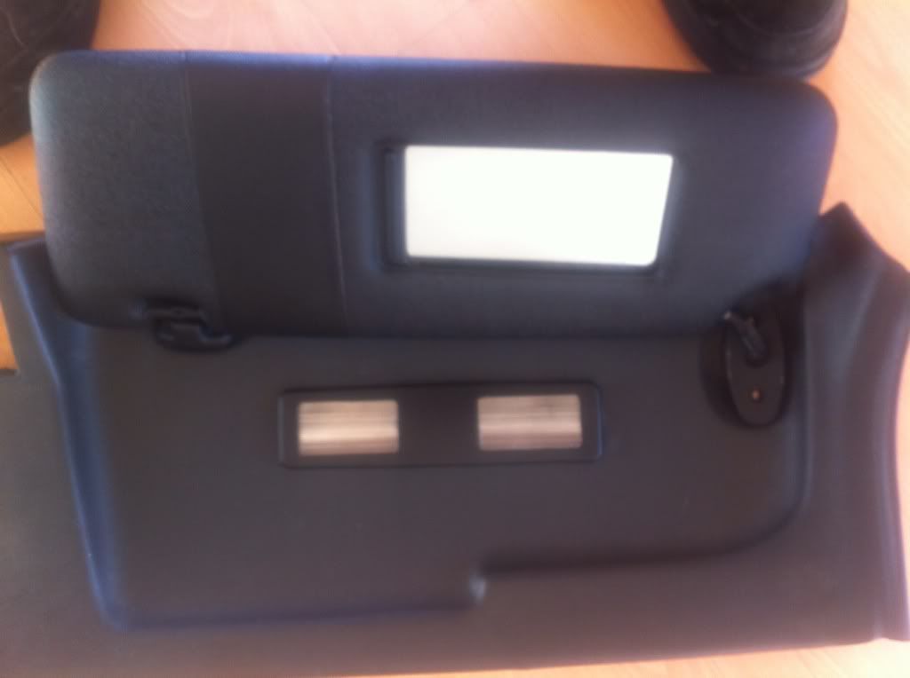

    You can either take out the headliner cover or do it in the car.

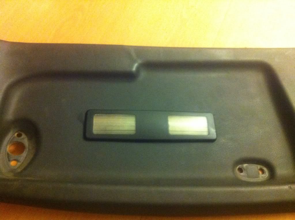

    First measure the size of the light and make sure its centered. Make sure you dont make the hole too big or the light will be loose and fall off.
    Install light on the hole you just cut.

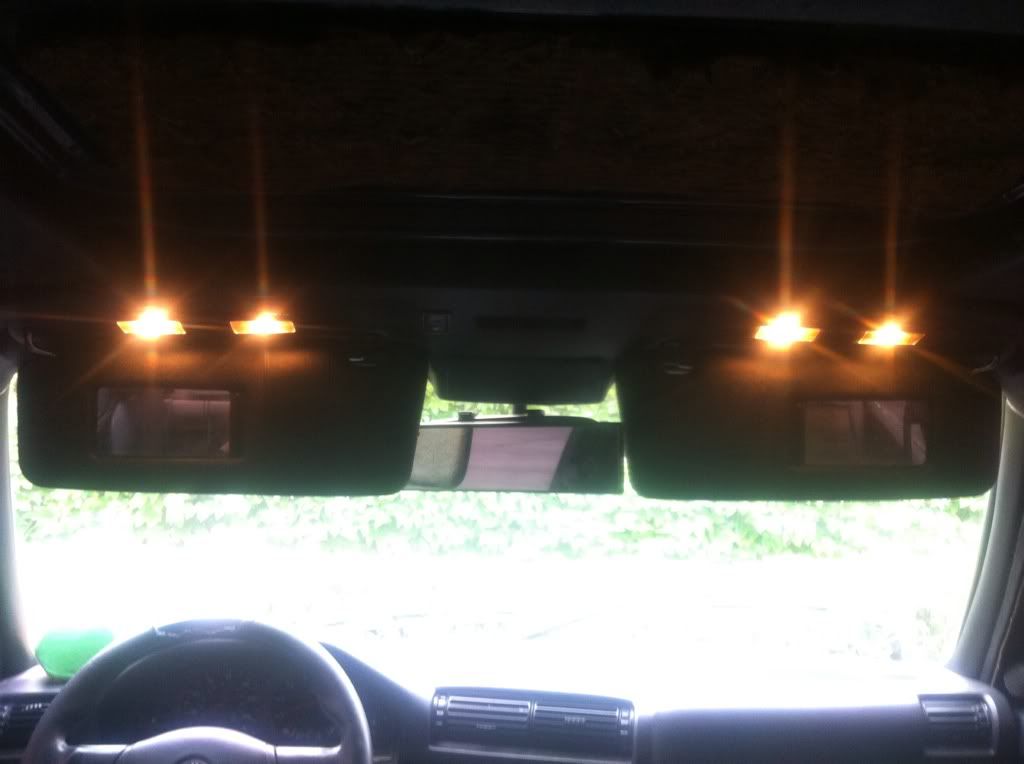

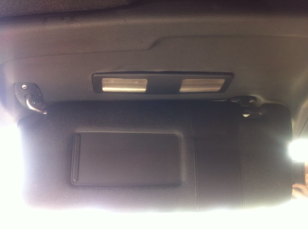

    Install headliner cover (only If you took it out of the car, I decided to do it while on the car. Connect the harness to the visors and lights. I got power from the factory dome lights.

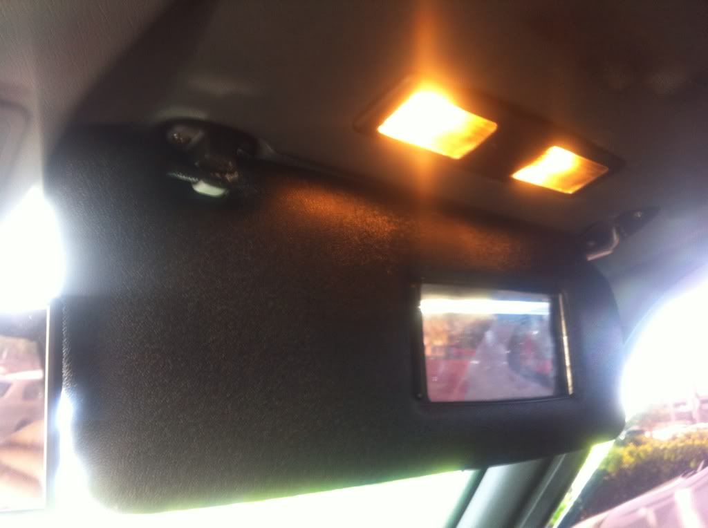

    Looks pretty decent. Visors don't close all the way, as seen in one of the pics, but it's not by much.
    Light lights up when you open the lid, and turns off when you close the lid.
