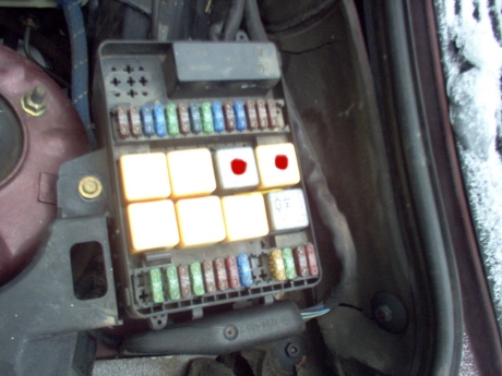

also decided i'd do the relay low-high beam thing, and that was very easy as well.

ran out of time (cold december rain) before i got the city lights done, but I popped out one of the side markers before I quit for the day, and it didnt look as self explantory as i hoped. anything i need to know? also, do i have to solder a jump on the relays, or have some of you just wrapped it? thanks, again, r3vlimited FTW.Comment
