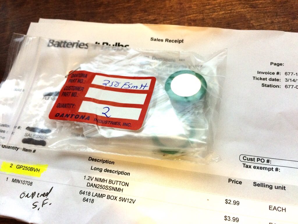

            I wanted the flashlight for originality reasons but also wanted it to work, I know it's just a cool factor at this point. I did a little research and found a write up about how to change out the batteries since the battery is typically the reason the light doesn't work.
            How to write up:
            Link to batteries in the states:
            http://bit.ly/SNNfnC

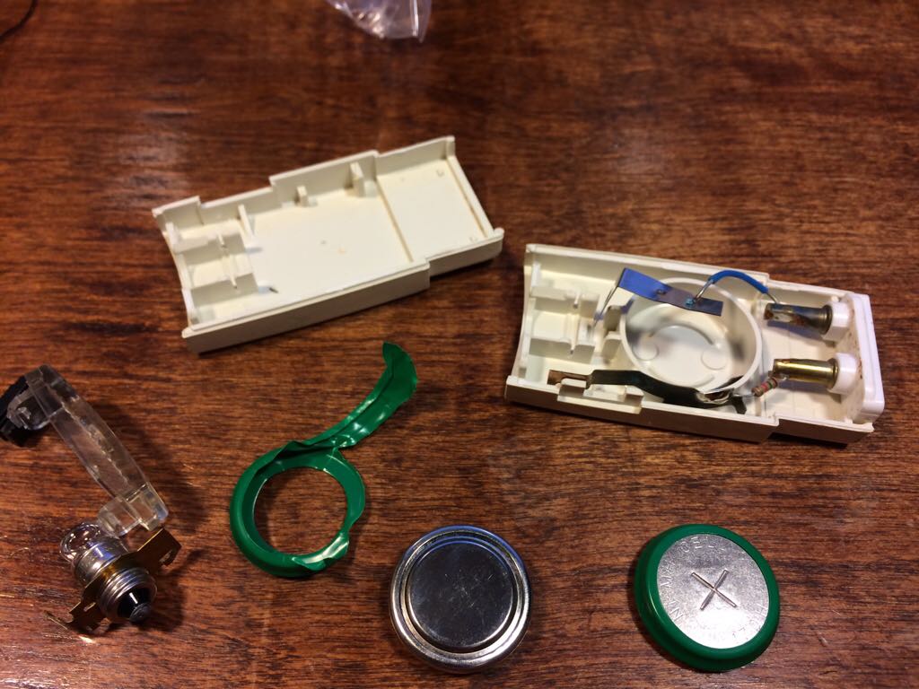

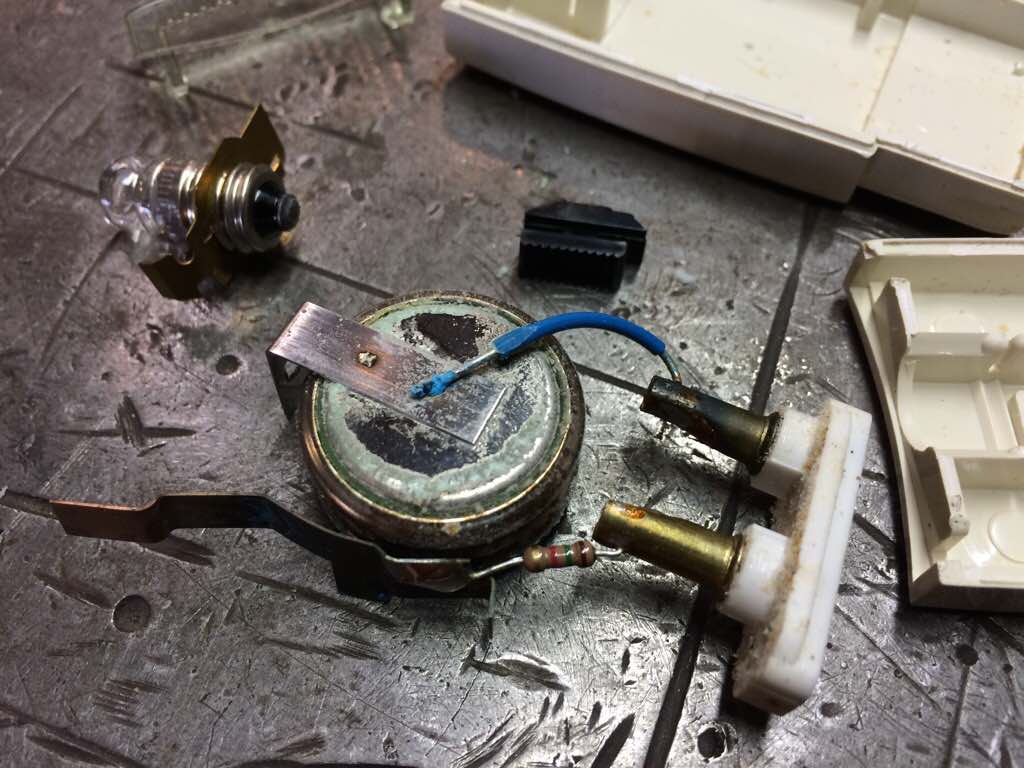

              I'll be restoring and upgrading my flashlight soon, just waiting on parts. Found a local place called batteries plus bulbs that has the battery for $2.99 each, but it's gotta be shipped from the east coast :/ They also had a bulb for the license plate light, yay! And found an e10 bulb led replacement for the flashlight on ebay for *gasp* $15 shipped from the UK. Says 120 lumens, but kinda skeptical. My AA mag light does 287 or something lumens, so there may be hope for a pissed off bmw flashlight!
              Blew it apart. Mmm crusty.

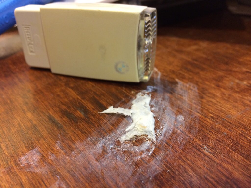

                How hard was it for you to get the case apart? Did the case suffer pry marks?
                • jdt10768
                  • Feb 2013
                  • 484
                  you can use a razor blade or sharp knife to pry apart, just be careful and go slowly as you pry - it will come apart without cracking or marks
                  • Navarone
                    • Jun 2014
                    • 935
                    I pulled the bulb out and pried out from the inside sorta. It helped not leave visible marks.

                      Where to source those batteries, does anybody know?
                      • Navarone
                        • Jun 2014
                        • 935
                        I got them at a local place called "batteries plus bulbs", they had to order them, but they were like $3 each. You can find them on eBay and around the web for about $4.

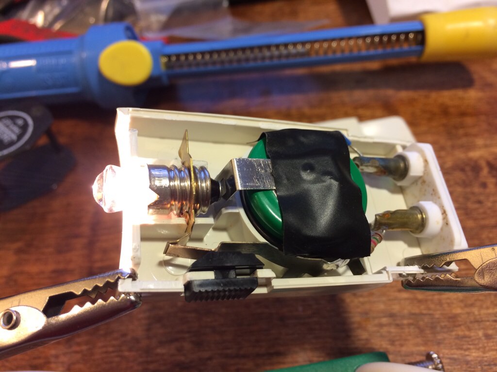

                          Glove box flashlight repair, how to.
                          Here you go, boo.
                          Originally posted by Navarone
                          New batteries for the glovebox flashlight came today!! 120lm led still in the mail. Can't wait for the led, this bulb is totally useless in a flashlight.
                          Prep. I didn't get a battery with solder tabs, but the tab with the blue wire spot welded to it doesn't let solder stick anyway.
                          Bent the tab for some tension, and held in with tape long enough to glue the cover closed with a couple drops of super glue.
                          Woo hoo!!
                          Tried to clean the yellowing. BMW logo came off, yellow didn't. Oh, and I hate superglue so much!! What a life.
