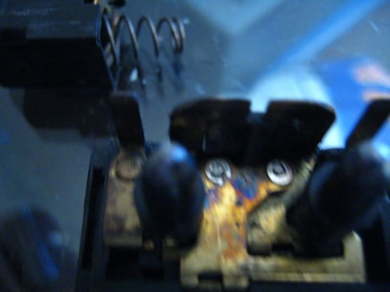

    one of my powerwindow switches would always stop intermittently. I got annoyed with it and decided to take apart my switch to see wtf was going on.

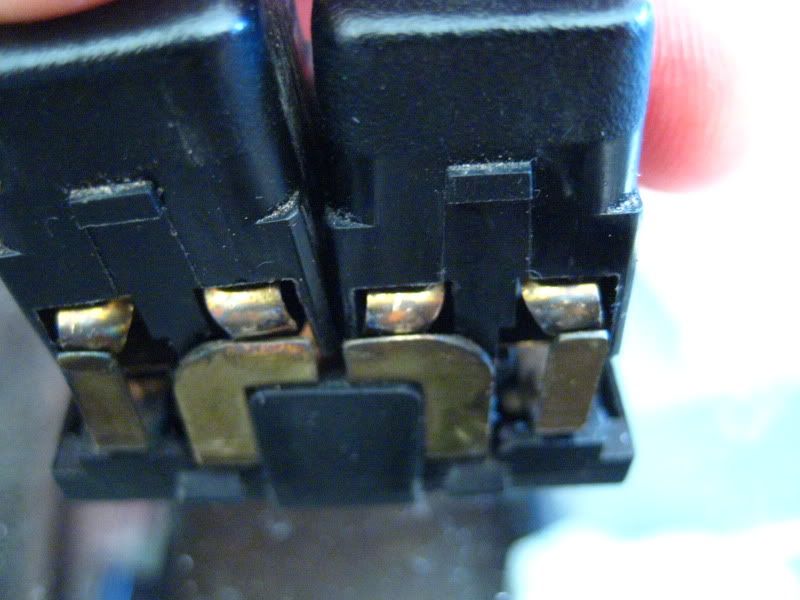

    basically for the powerwindow switch to work, the 4 contacts pictured have to touch at rest. when you push up or down, this breaks the circuit. over time, the contacts need to be bent back into shape.

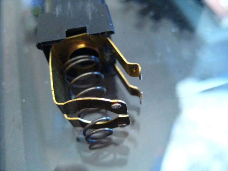

    just bend the prongs outward
    Another area to check is
    while I had my switch apart, I cleaned everything up.
    there you go, now you have a working switch.
