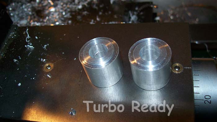

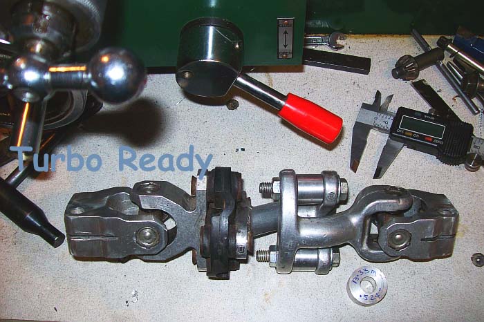

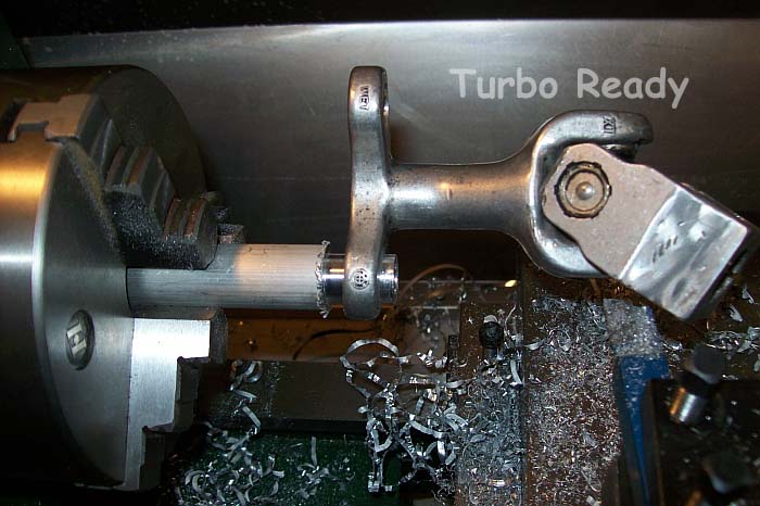

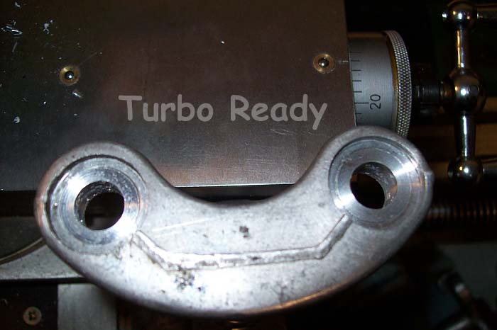

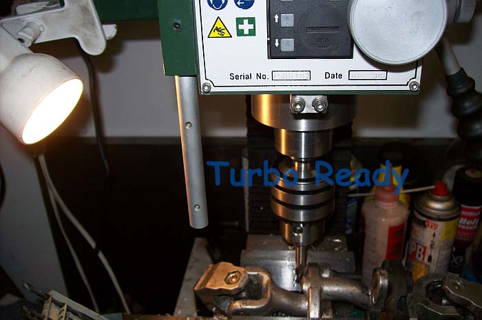

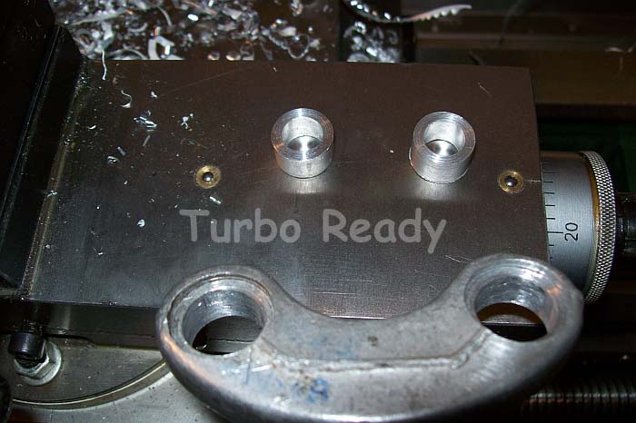

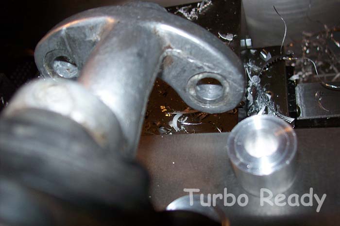

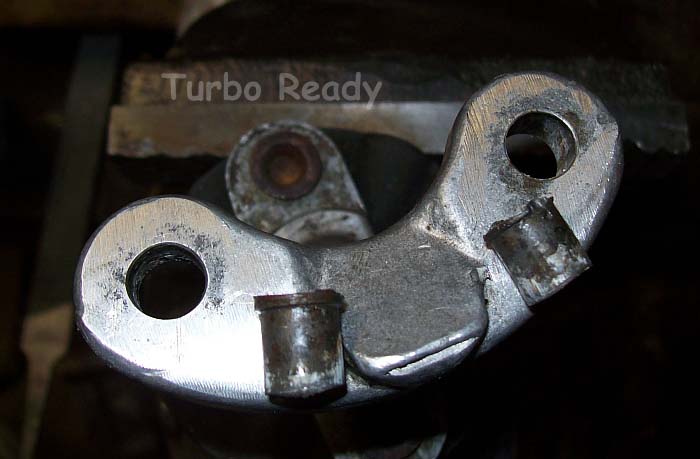

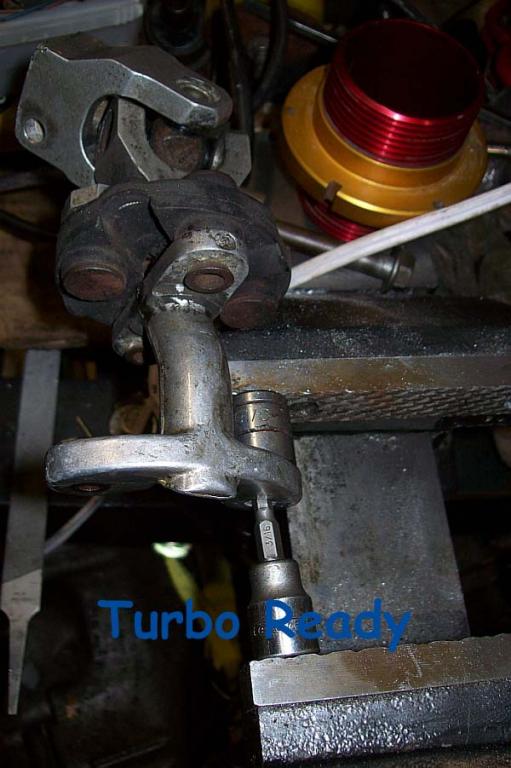

                    No replies so I went ahead and did this.
                    I had to cut the rivets between the knuckles since removal of the ends did not separate them. The longer remaining part of the rivets came off in my vice with a fight but the shorter pieces where I machined the end of the rivets would not budge.
                    I placed them in my vice and got them out with an old socket and a hex driver, my 30 ton press would have been an over kill :D I applied some pressure on it and they came off with a bang.
                    You can see the pics of the lil suckers which were suck. The plastic inserts were shot and so I machined some aluminum ones, they have a factory fit and finish. I machined some tiny grooves in them, applied some JB weld and pressed them in.
                    Both sides of the knuckles have recessed seats where the bolts are so I machined the spacers with an exact extension to fit the recessed seats, it not only makes the spacers fit square and tight, but allows them to have more surface area when tightened. I am happy with the fit and finish though it took me a couple of good hours to measure and machine the four pieces.
                    You can also see the spacers I made for the rack to be mounted on the subframe.

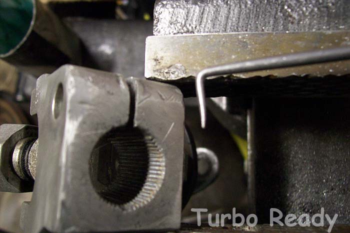

                      #310
                      More
                        I had this same problem last night. I ground down the rivet heads and those things do not want to budge. I guess I will have to press them out like you did. Thanks for the pictures.
