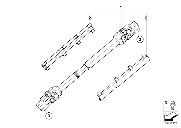

    I don't suppose the splines are the same…..?
