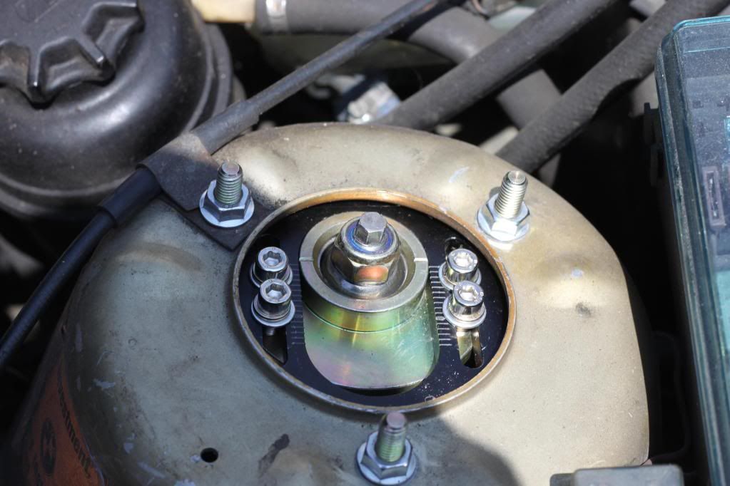

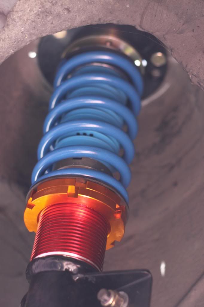

                        First we shorten the strut tubes 1.9" and add a collar along with AKG sway link tabs. Welding done by Chris Castro of Castro Motorsports.
                        Pics installed with my GE camber plates and coilover dust boots. 6" #300 springs
                        Rear installed with GE tall RSMs 4" #800 springs (14lbs of boost and a stereo system makes the car squat hard)
                        Rear all the way down and fronts all the way up. Will be switching to 7" springs
