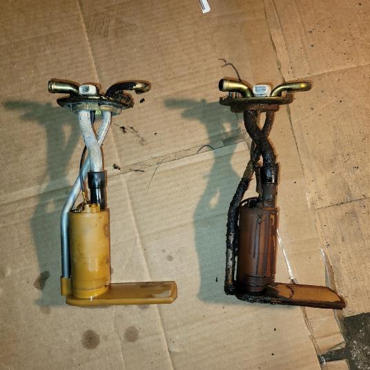

                    Just got the TRE to replace both pumps on my 87is.
                    Originally I pulled the assembly off an 84 I just got, thinking I would leisurely do it and then swap but it was SUPER nasty and the 10y of sitting did not do good for it.
                    I measured from the top of the case to the bottom of the filter and ended up with a difference of about 20mm.
                    I removed 20mm from the main output tube (hand saw is easy to cut this, you don't want to use power tools as this is still fuel related and it's an unnecessary risk) and attached with clamps (I don't know what they are called but they are the OE style crimp clamps for fuel lines, I got a kit on Amazon pretty cheap), one was 17mm the other was 22mm.
                    Soldered and shrink wrapped the red line to the black from the assembly. I was thinking about desoldering the line from the connection on the assembly and just running the red wire to that but was wanting to get it done so I just did as mentioned. I did notice that the wire from the TRE pump was slightly heavier gauge so if someone is worried about delivery, desoldering the connection and just running it straight to it would not be hard at all.
                    My car is totally stock and this one will remain that way so I am not too concerned.
                    Instead of soldering the black wire to the feed line as shown here, I used the ground point that was already available, where the original pump grounded to.
                    This seemed to simplify things for me a bit as then you don't have to worry about the quality of your solder to the tube. That tube is good sized and a major heatsink. If it's not pretty clean and soldered just right, it may not stick.
                    I crimped a small eye on the black wire, shrink wrapped it, and attached it with the original clip and screw that held the ground for the original pump and it is putting out fuel great.
                    As for the fuel pump "blanking", I bought a 1/2x5/16 brass barbed reducer off Amazon for $6. I was familiar with these when I did fuel system retrofit/upgrade on my 83 Westy and needed something similar. If you are in a hurry and need it literally right now; you can piece it together but in the long run, one solid piece is going to be much better/safer.
