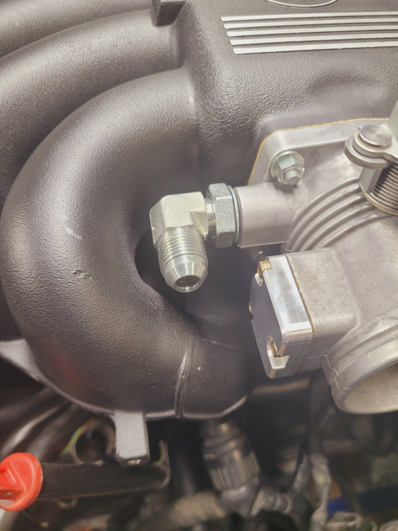

      I managed to find a fitting that works for the ICV side. There is an o-ring and a nut on the M18 side so you can align it correctly and get it tight without needing PTFE tape. The other side is billed as 1/2" male JIC which AFAIK is the same as 3/4-16 & 8 AN.

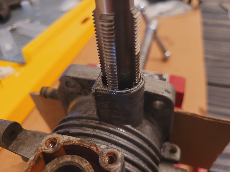

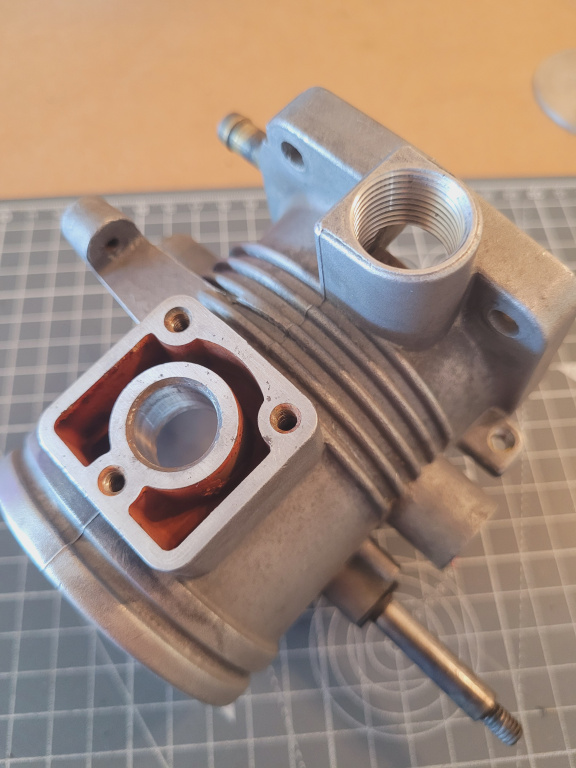

      M18x1.5 appears to be the correct size, but no drilling is required, just a HS tap. The hole is 17mm, so M18x1.5 gives 50% thread engagement. The next closest I found is 3/4-16 with 100% thread engagement which comes to 16.986mm but I don't like the sound of 100% thread engagement.

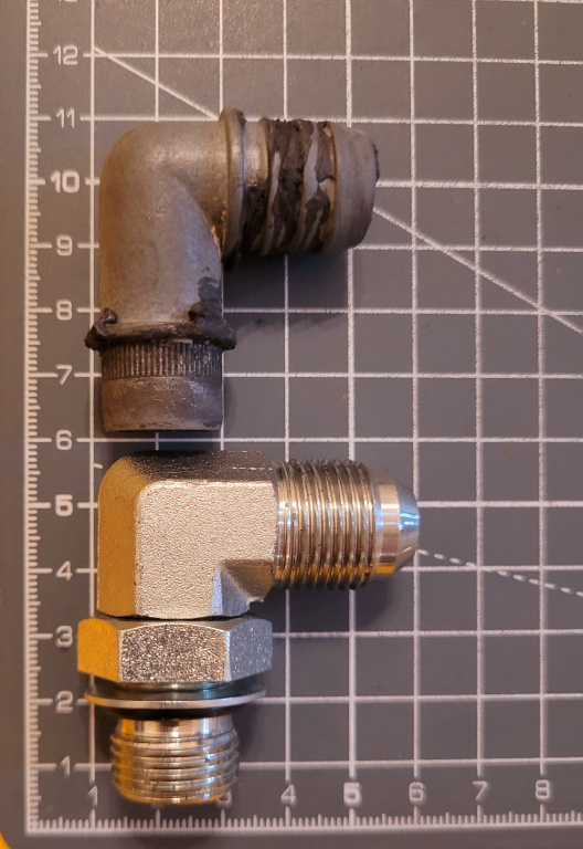

      Comparison with original fitting:
      M18x1.5 HS tap on a Lisle 70900 #11 Tap Socket

        The 1/2" JIC/8AN threads appears to be a good size where you can screw the fitting into a new rubber hose (part no 13411718777). If it doesn't seem to be sealing will maybe put some RTV or JB Weld on the threads to make it into more of a barb that will take a hose clamp.
