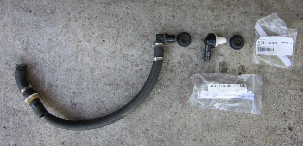

          The late model single vacuum hose design doesn't show up on RealOEM, but I found another thread where a guy posted this picture and said this:
          "Old hose on the left has what looks like an in-line check valve with OEM clamps. The fitting at the booster is just an elbow.
          The new part from Blunt is a check valve in the 90 degree fitting, plus new grommet."
          Apparently this 90 degree check valve is now superceded according to a few sites but I found that ECS carries it for $5
          https://www.ecstuning.com/b-vaico-pa...331156703~vai/
          What I want to confirm is that if I bought this 90 degree check valve and put it in the place of the elbow fitting on the brake booster, I could then run a straight vacuum line from the brake booster to the throttle body correct?
          Another option that I found is by using an E21 vacuum check valve (part number 34331151533A), which is only $8, also available on ECS. With this you would run the original elbow fitting on the brake booster and then run the E21 check valve in line to the throttle body. It seems like these two options achieve the exact same results.
          Anyone know why the 90 degree check valve is superceded? Did they fail a lot or something? Or did they just realize that selling the complex 4 way check valve would be much more profitable?
          I just want to simplify my setup as much as possible. Any input would be appreciated. Thanks

            Who knows but my eta had the single like the pic you posted. Then when I converted to 325i motor I got the double check valve.

              Hey sorry for the late reply. The valve is the original check valve from when this car was from an eta. 90 degree or straight doesn't matter as long as it's put in the right way around. The brass pipe on the throttle body is plugged because I vented the charcoal cylinder directly to the air. My evap valve was faulty and I couldn't afford a new one. Hope this helps!

                  For anyone doing this mod, it is also helpful to know what to purchase to simplify your vacuum routing as well going to the brake booster. What you'll need for that (via chubby chowder's thread):
                  Intake boot without vacuum port (part number 13711726325):
                  https://www.ecstuning.com/b-mtc-part...711726325~mtc/
                  90 degree check valve (part number 34331156703):
                  Brake Booster grommit for check valve (34331158929):
                  https://www.ecstuning.com/b-original...331158929~oes/
                  And then just one hose going from the 90* check valve in the booster to the throttle body barb.
                  Total costs (with shipping because it's a killer on all of these fittings):
                  -Intake Elbow, check valve, and grommit from ECS: $39.02
                  -7/16-20 tap and 25/64 drill bit (amazon): $16.36
                  -Brass Hose Barb: $8.61
                  -Socket Set Screw Cup Point 304 SS - 7/16"-20 x 3/4" (Albany County Fasteners): $8.34
                  -NPT Elbow (BuyFittingsOnline): $23.61
                  Total: $95.94
