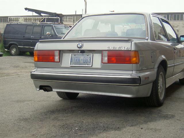

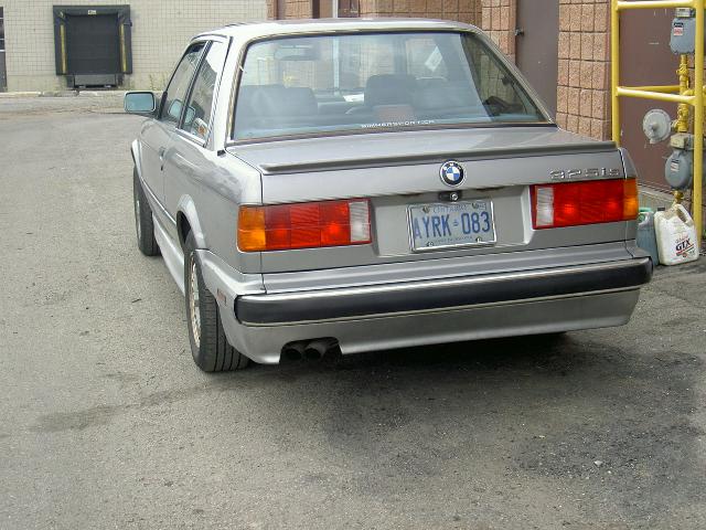

            For those of you too cheap to go with the MTech 2 setup you can easily pop rivet an 88+ rear valance on the rear to improve the swap look. Here's some pics of what I recently finished up last night. I will post more as I finish the project.

              Looks good. Is this the valance that comes on the plastic bumper cars? Where does the valance/ rear ende rivit at? I can't even see the line.

                ^^ what he said. did you just pop the new valence on to of the old one, or did you actually go and cut the old one off??

                  I just pop riveted the new old onto the old one. I should have taken pictures before I sprayed the primer on it.
                  The rear valance is from a 89 325is I got from Funkmasta through the F/S forum along with the bumpers and front valance.

                          Ritalin, did the late-model rear apron stick into the fender well like the bumper does? Or was it a straight, even fit? I just found one.

                              It was a straight even fit. What I did was slid the bumper on the shocks and had a friend hold one side up even while I held the other side up and we took a marker and marked where the bottom of the bumper was.
                              We used this as a reference to line up the top notch in the valance that the bottom of the bumper needed to be lined up with. We then used the weld marks at both corners of the rear to match up the valance vertically. We then rivetted the middle back on first and worked our way around. In the process we kept putting the bumper back on to make sure we did not get off track.
                              The cool thing about rivets is that you can always drill them out if something screws up. Be sure to use steel or stainless steel rivets. Aluminum and steel like to oxidize over time meaning eventually the rivets will fall out.
