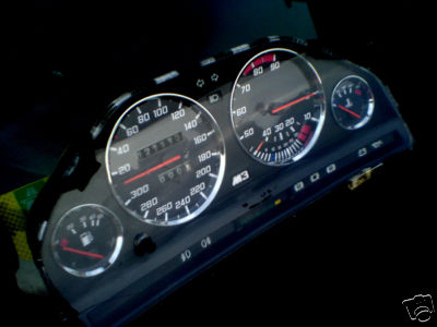

            Or just get a new cluster and update the look
            very affordable.

                  Very ... whatyoumaycallit ?
                  Mang, I knew it !
                  I been telling my friend that his 325eS always seems like it's moving faster than speed readout.
                  Well not just moving faster, his engine does sounds like it goes up to 11k's,
                  so he'll have to UPGRADE that. 8) jk

                    Originally posted by Javier h
                    very affordable.
                    You got a link to where to get that gauge assembly?

                      wtf is up with that tach? The needle goes down around the encono? The speedo goes to 300 instead of spreading the numbers out to give you an easier read in normal situations like... BELOW 100?!?! Ugly/dumb product, and dont buy a used speedo off ebay because guess what... its gears are going to fail soon too just like your current one.
